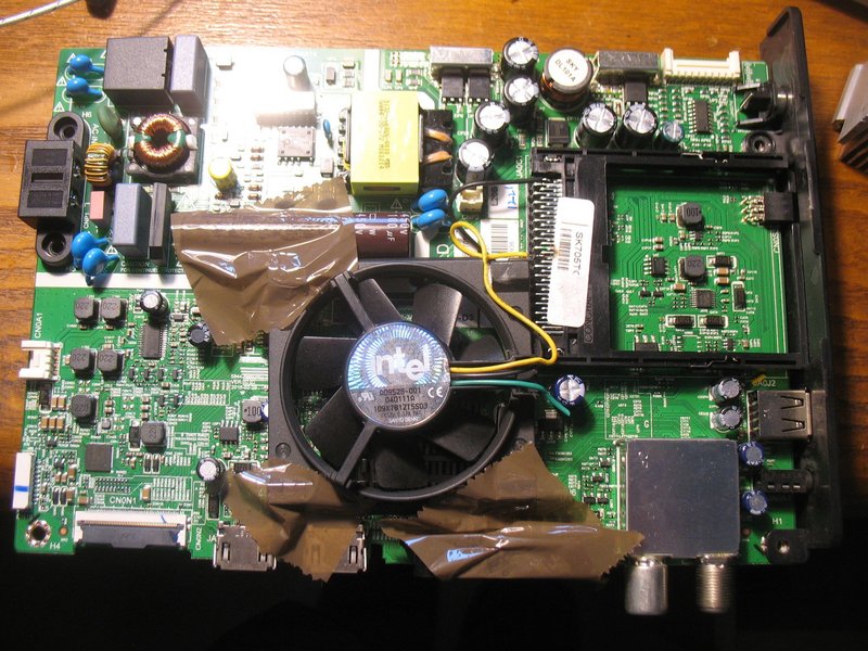

  3. Strong SRT 32HY4003 Thermal Shut-off workaround with additional FAN, Active cooling with a fan: étape 3, image 1 de 1
    • Active cooling needs power supply. In "upper center" of the board is a 12V DC power connector (CNP2) that could easily be used. But this is always on - even in standby. I don't want to have the fan rotating also in standby - makes noise, wastes energy and reduces FAN lifetime
    • without deep circuit reverse engineering two more 5volts DC power sources are obvious: USB connector and the PC Card slot. Both are supposed only to be powered if TV is switched on. Their use presumes that current draw of the FAN will not influence their operation.
    • As I do not need PC Card slot (Pay TV, etc.) but USB I chose the PC Card pins 17&34 (VCC&GND) to get 5 volts (pls. verify correct pin selection with multimeter!)

  5. Strong SRT 32HY4003 Thermal Shut-off workaround with additional FAN, Fan implementation: étape 5, image 1 de 3 Strong SRT 32HY4003 Thermal Shut-off workaround with additional FAN, Fan implementation: étape 5, image 2 de 3 Strong SRT 32HY4003 Thermal Shut-off workaround with additional FAN, Fan implementation: étape 5, image 3 de 3
    • With selected FAN I used the TV's original heatsink again. FAN housing fits flawlessly over the heatsink and inside the TV's rear housing. First trials I did with tape(photo), later I glued the FAN housing with hot glue to the mainboard.
    • without rear housing temperature on heat sink surface dropped down to incredible 29degC (ambient temperature 21degC), however, with rear housing it rose up again to about 44 degC.
    • First I thought about drilling additional holes in the housing, but finally I decided just to remove the lateral and bottom output interface covers of the rear housing. This might be ok for you as well, as these covers are distal to the HOT area, so there is no risk of direct contact to high voltage. This way I now get 39 degC after several hours
    • Margin to shut-off temperature is about 10 deg., so I probably need ambient temperature of 30 degC until I will run into trouble again. That seems to be ok for me for now., 30degC in my room would be pretty tough, but let's wait for next summer.
