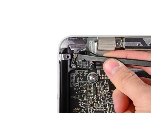

Image 1/1:
  • Use the flat end of a spudger to pry the Bluetooth antenna cable connector up from its socket on the Bluetooth board.
Ajouter un commentaire

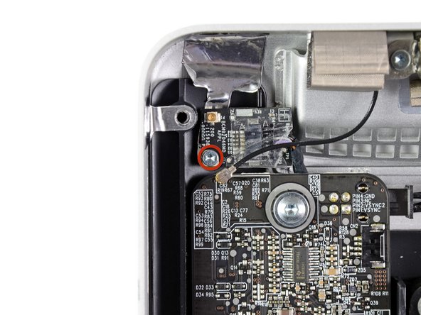

Image 1/1:
  • Remove the single 6.6 mm T8 Torx screw securing the Bluetooth board to the outer case.

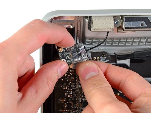

Image 1/1:
  • Remove the piece of tape wrapped around the Bluetooth board.

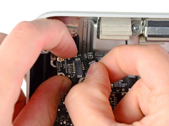

Image 1/1: Remove the Bluetooth board from your iMac.
  • Disconnect the Bluetooth cable by pulling its connector away from the socket on the Bluetooth board.
  • Remove the Bluetooth board from your iMac.
