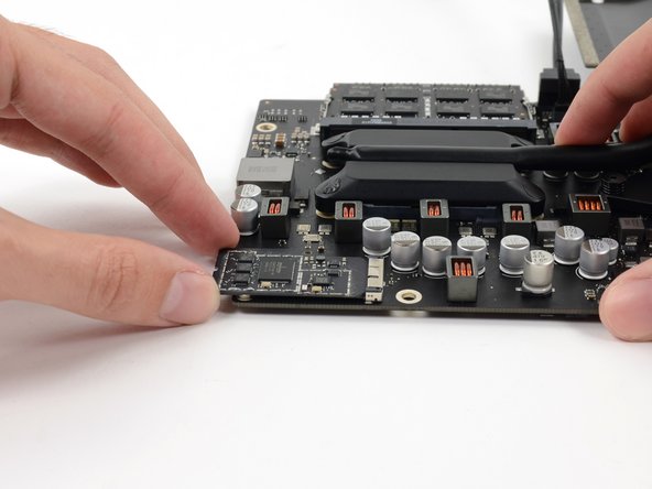

Introduction
Use this guide to replace your AirPort/Bluetooth card.
Image 1/1: '''Before beginning any work on your iMac:''' Unplug the computer and press and hold the power button for ten seconds to discharge the power supply's capacitors.
  • With the hinge free to move, the iMac will be unbalanced and hard to work on. Repairs can be completed as shown, but are faster and easier with an iMac service wedge.
  • Before beginning any work on your iMac: Unplug the computer and press and hold the power button for ten seconds to discharge the power supply's capacitors.
  • Be very careful not to touch the capacitor leads or any exposed solder joints on the back of the power supply. Only handle the board by the edges.

Image 1/3: The hard drive is attached by two cables, do not attempt to fully remove it from the iMac.
  • Lift the hard drive from the edge nearest the logic board and pull it slightly out of its recess.
  • The hard drive is attached by two cables, do not attempt to fully remove it from the iMac.
Ajouter un commentaire
Image 1/2:
  • Disconnect the SATA power cable.
Image 1/2:
  • Unplug the SATA data cable from the hard drive.
Image 1/1:
  • Remove the hard drive from the iMac.

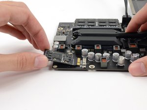

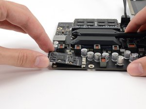

Image 1/3: '''Do not''' use excessive force to pull the end of the AirPort/Bluetooth Card away from its socket on the logic board. Doing so may damage the socket.
  • Slightly lift the AirPort/Bluetooth card and pull it straight out its socket.
  • Do not use excessive force to pull the end of the AirPort/Bluetooth Card away from its socket on the logic board. Doing so may damage the socket.
  • When reinstalling the card, be sure it is properly seated before reinstalling the retaining screws.
I addition to the two Torx5 screws, My Wi Fi bluetooth card was glued to the main board with a grey porous glue that was easy to peel off once I got the card loose.
