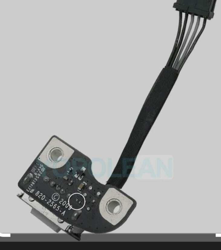

repair Magsafe DC IN board used in MacBook Pro A1278
the problem is green or Amper LED is not ON. I traced center sense pin a resistor is missing between the center sense pin and the 5th EXT pin of MAX9940 ic, any one can help to find the value of resistor in DC in board

1 Réponse
Hey Mate!
For this; I'd suggest you don't solder and just buy yourself a new magsafe port; they aren't expensive. It's a pretty straightforward repair as well.
Here's one off ebay:
820-2565-A Apple MacBook A1278 A1286 A1297 Magsafe DC-IN Power Jack Board Cable- Australia
Cheers,
Falcon
