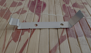

Where the heck did this clip come from?
I have a Bosch SHE89PW55N dish washer. I am replacing the front stainless steel panel because it was tired, had paint drips on it, etc. As part of that process, I removed the control panel. It may not have been necessary but the front stainless panel didn't seem to want to come off with the control panel in place. As I was doing that, this clip fell out. I have no idea where it came from.
I have scoured all parts diagrams I can find and come up empty. I have inspected the control panel trying to find a logical place for it, also no luck. I could not find anything like it on the control panel, inside the door, or on the stainless steel panel.
Does anyone know where this goes?

It looks like a spring retainer clip for possibly a control panel. Is anything wobbling when opening and closing your machine door?
par
Not at the moment.
par
with pics i would suggest another item in the pic for scale. a penny, a ink pen or something. Your saying "clip" and i think something small, yet that to me appears to be a mounting braket. I cant be sure because i am not processing what the item is the clip is sitting on to scale.
par
Additional pics attached to the original post
par

By some stroke of luck, Bosch's parts website shows the clip in the upper left corner of the control panel assembly.

Did you manage to find out where it fits into? Did it go inside there? In the same predicament.
par
I have same issue and still can’t figure out where it goes exactly - even with the most recent pic posted by Brian W.
par

I think i might have found it.. go back to your illustrated parts breakdown sites.
I believe it may be related to part #314,, a horizontal mounting / friction clip or braket.
You have to take into account sometimes things of this nature are not actually drawn exactly the same as they
are in real life. one of these two brakets i have arrows to is likely the item. its not an item for sale so to speak.
im trying to figure out how to upload a pic here.. stand by

Bosch's website shows part 0314 as a "strip" which I believe is the horizontal gasket along the top of the cabinet. There is a picture of this strip/gasket on Bosch's parts website here: https://www.bosch-home.com/us/en/product...
That strip is easy to see when I open the dishwasher, it runs along the top and snaps into place. The thing in the background of the parts diagram is the rail for the middle rack.
Hopefully this won't be marked as spam again.
The mystery clip is much smaller than that and definitely came from inside the control panel assembly.
