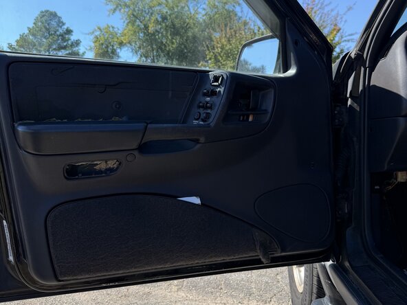

    • Remove the screw covers and set them aside.
  2. 1993-1998 Jeep Grand Cherokee Door Panel Clips Replacement: étape 2, image 1 de 2 1993-1998 Jeep Grand Cherokee Door Panel Clips Replacement: étape 2, image 2 de 2
    • Remove the screws from beneath the screw covers.
  3. 1993-1998 Jeep Grand Cherokee Door Panel Clips Replacement: étape 3, image 1 de 3 1993-1998 Jeep Grand Cherokee Door Panel Clips Replacement: étape 3, image 2 de 3 1993-1998 Jeep Grand Cherokee Door Panel Clips Replacement: étape 3, image 3 de 3
    • Carefully remove the panel from the door frame.
    • Make note of the connectors that send power to the inside switches.
    • Disconnect the power connectors and set the panel aside.
    • Be careful; if the connectors are not properly disconnected, you might get shocked.

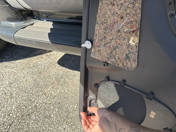

  4. 1993-1998 Jeep Grand Cherokee Door Panel Clips Replacement: étape 4, image 1 de 3 1993-1998 Jeep Grand Cherokee Door Panel Clips Replacement: étape 4, image 2 de 3 1993-1998 Jeep Grand Cherokee Door Panel Clips Replacement: étape 4, image 3 de 3
    • Detach any remaining clips in the door using pliers.
    • Be careful with the pliers, as you can accidentally cut yourself with them
    • Clean the frame of debris.
  5. 1993-1998 Jeep Grand Cherokee Door Panel Clips Replacement: étape 5, image 1 de 3 1993-1998 Jeep Grand Cherokee Door Panel Clips Replacement: étape 5, image 2 de 3 1993-1998 Jeep Grand Cherokee Door Panel Clips Replacement: étape 5, image 3 de 3
    • Clean the panel you removed in Step 3 of dust and debris.
    • Make note of the notches where the clips go.
    • Take the clips and place them along the door panels, replacing any that do not fit snugly.
