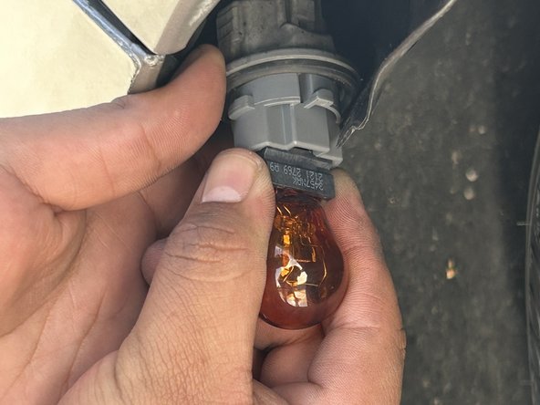

    6. 2006-2013 Toyota Corolla Turn Signal Bulb Replacement: étape 6, image 1 de 3 2006-2013 Toyota Corolla Turn Signal Bulb Replacement: étape 6, image 2 de 3 2006-2013 Toyota Corolla Turn Signal Bulb Replacement: étape 6, image 3 de 3
      • With one hand grab the socket and with the other pull the bulb straight out of the socket.
