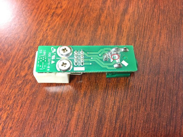

Finally, like the third picture, remove the AUX circuit with force but try to be gentle also.
The center pin is located where the red circle is at on the picture
Hold the soldering gun in one hand and the solder in another. Lightly touch them together where the pin is shown in previous step.
Soldering does not have to be perfect as long as it connects the two pin we located in the previous picture.

You are the man! This is perfect, it defeats the automatic change source when the cable is removed thing. I think what was happening is that the contacts on the plug got old and dirty and the radio was seeing very short disconnections, like a millisecond and was thinking that the cable was removed and switching inputs. This mod makes the radio think that the cable is always plugged in so it stays on the aux input, it's the way the radio should have been designed. The aux connection stays stable and it works perfectly, everyone should do this mod!
Much appreciated! I was getting so frustrated with this issue, very glad you put this guide together. I had some trouble trying to remove the AUX circuit from it’s protective housing, but then realized you don’t need to. So I pulled it out just enough to solder the 2 pins then put it right back in.
