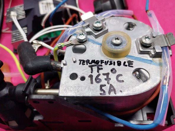

  4. Compilation of thermal fuse values ​​for boilers, used in household appliances.: étape 4, image 1 de 3 Compilation of thermal fuse values ​​for boilers, used in household appliances.: étape 4, image 2 de 3 Compilation of thermal fuse values ​​for boilers, used in household appliances.: étape 4, image 3 de 3
    • Nespresso coffee machines, Delonghi, and many similar models.
    • 2 thermal fuses on the boiler, one on each side, secured by a metal plate and screw.
    • 167º - 5 A
