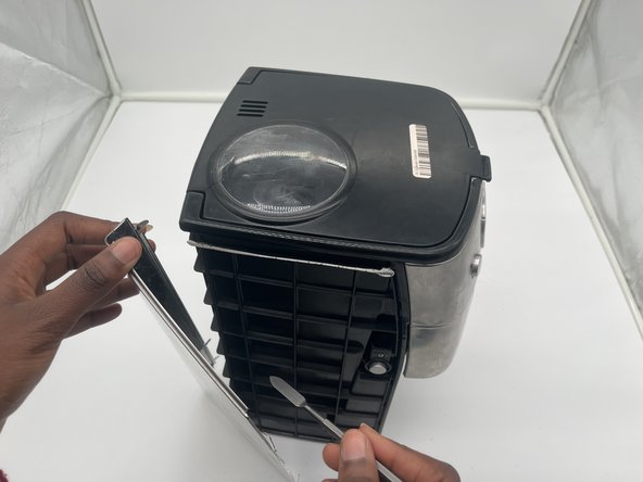

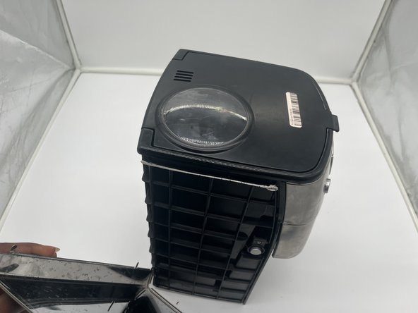

    1. Cuisinart DGB-650 Filter Basket Door Release Button Replacement, Filter Basket Door Release Button: étape 1, image 1 de 3 Cuisinart DGB-650 Filter Basket Door Release Button Replacement, Filter Basket Door Release Button: étape 1, image 2 de 3 Cuisinart DGB-650 Filter Basket Door Release Button Replacement, Filter Basket Door Release Button: étape 1, image 3 de 3
      • Wedge the metal spudger in between the metal plate and the plastic of the coffee maker and remove the metal plate.

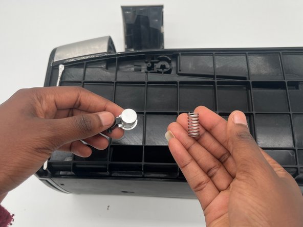

    2. Cuisinart DGB-650 Filter Basket Door Release Button Replacement: étape 2, image 1 de 3 Cuisinart DGB-650 Filter Basket Door Release Button Replacement: étape 2, image 2 de 3 Cuisinart DGB-650 Filter Basket Door Release Button Replacement: étape 2, image 3 de 3
      • Remove the 1.2 mm screw holding down the plastic button clamp using a Phillips #0 screwdriver.
      • Remove the button clamp.
      • Remove the button and attached spring.
