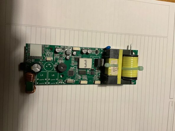

Power supply
The power supply is accessible from the bottom of the unit. 4 Phillips head screws hold the bottom cover in place. There is a single circuit board with both low voltage and stepped up voltage components.
- Low voltage side includes electrolytic capacitors, which are common failure points.
- High voltage side includes the large windings of a step up transformer and a large capacitor connected to its output.

If you are getting flakey light and fan motor behavior, focus on the middle tier - the filtering elements. Broken, dirty or bent corona wires. Cracked electrical connections on the edge of the collector plate housing (was my problem).
Unit can make electronic sounds, stepped up phaser noises, etc. all high voltage discharge arcing from dirt or broken parts. If middle tier is fine, test small capacitors, look for bad solder joints, burnt components.
