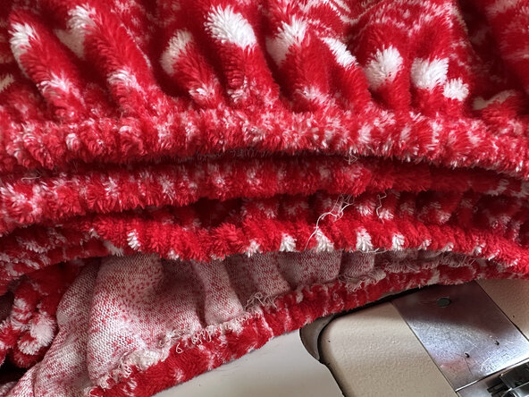

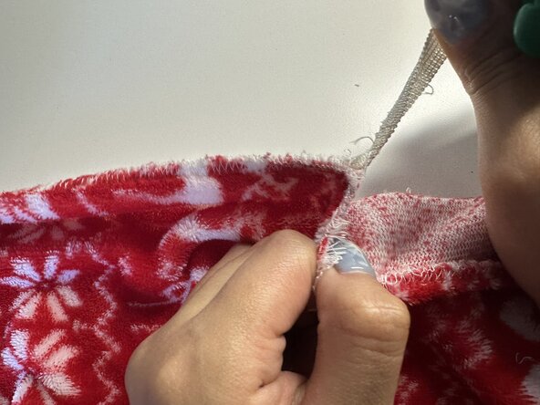

  1. Fitted Bed Sheet Elastic Replacement, Elastic: étape 1, image 1 de 3 Fitted Bed Sheet Elastic Replacement, Elastic: étape 1, image 2 de 3 Fitted Bed Sheet Elastic Replacement, Elastic: étape 1, image 3 de 3
    • Make a small cut in elastic casing at the edge of the fabric seam to access the elastic inside.
    • With your sewing scissors, carefully cut the stitches that attach the elastic to the fabric, if sewn in place.
    • On some sheets, the elastic isn’t sewn directly to the fabric—it’s threaded through a casing and can be pulled out.
    • Gently pull the elastic to detach it from the fabric.
    • Continue cutting and pulling the elastic until it completely detaches from the casing.

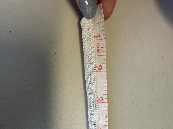

  2. Fitted Bed Sheet Elastic Replacement: étape 2, image 1 de 2 Fitted Bed Sheet Elastic Replacement: étape 2, image 2 de 2
    • Use a measuring tape, to measure the length of the old elastic.
    • Keep the elastic as flat and straight as possible to get an accurate measure. This will help you determine the length of the new elastic.
