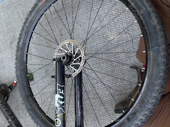

  1. Fox32 Mountain Bike Front Air Suspension Fork Seal and Oil Replacement, Fork Seal and Oil: étape 1, image 1 de 1
    • Begin by finding a flat location to lay your bike down.
    • Be prepared for your bike to stay in this location until the fork has been serviced (potentially several hours).

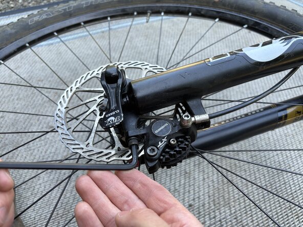

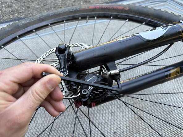

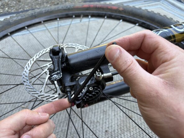

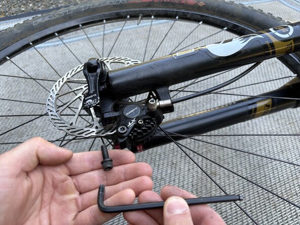

  2. Fox32 Mountain Bike Front Air Suspension Fork Seal and Oil Replacement: étape 2, image 1 de 3 Fox32 Mountain Bike Front Air Suspension Fork Seal and Oil Replacement: étape 2, image 2 de 3 Fox32 Mountain Bike Front Air Suspension Fork Seal and Oil Replacement: étape 2, image 3 de 3
    • Begin to remove the front brake caliper. Find the appropriate sized Allen key from your set, and remove the bolt by turning it counter clockwise.
    Demander à FixBot
    Ajouter un commentaire
  3. Fox32 Mountain Bike Front Air Suspension Fork Seal and Oil Replacement: étape 3, image 1 de 3 Fox32 Mountain Bike Front Air Suspension Fork Seal and Oil Replacement: étape 3, image 2 de 3 Fox32 Mountain Bike Front Air Suspension Fork Seal and Oil Replacement: étape 3, image 3 de 3
    • Remove the second front brake caliper bolt by unscrewing it counter clockwise.
    Demander à FixBot

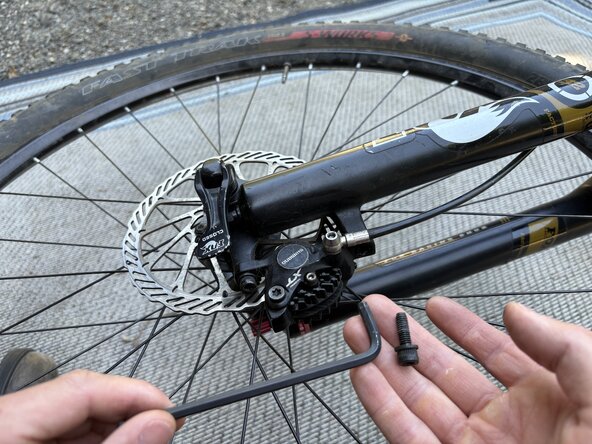

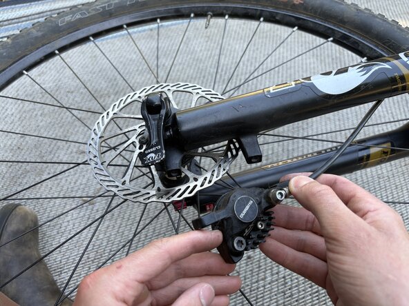

  4. Fox32 Mountain Bike Front Air Suspension Fork Seal and Oil Replacement: étape 4, image 1 de 2 Fox32 Mountain Bike Front Air Suspension Fork Seal and Oil Replacement: étape 4, image 2 de 2
    • Remove the front brake caliper.
    Demander à FixBot

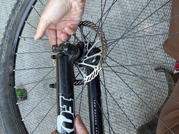

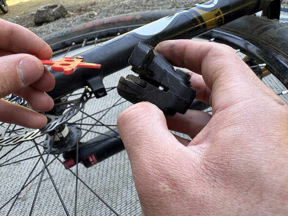

  5. Fox32 Mountain Bike Front Air Suspension Fork Seal and Oil Replacement: étape 5, image 1 de 3 Fox32 Mountain Bike Front Air Suspension Fork Seal and Oil Replacement: étape 5, image 2 de 3 Fox32 Mountain Bike Front Air Suspension Fork Seal and Oil Replacement: étape 5, image 3 de 3
    • Insert the caliper pad spacer to ensure the pistons cannot move while the caliper is off the fork.
    • You can alternatively use a wooden shim to keep the brake pads separated.
    Demander à FixBot

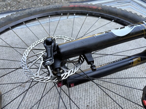

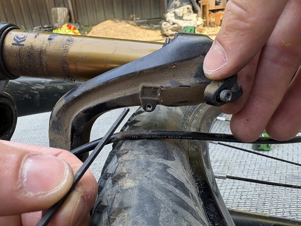

  6. Fox32 Mountain Bike Front Air Suspension Fork Seal and Oil Replacement: étape 6, image 1 de 2 Fox32 Mountain Bike Front Air Suspension Fork Seal and Oil Replacement: étape 6, image 2 de 2
    • Reinstall the brake caliper bolts into the fork for safe keeping. Insert and turn clockwise.
    Demander à FixBot

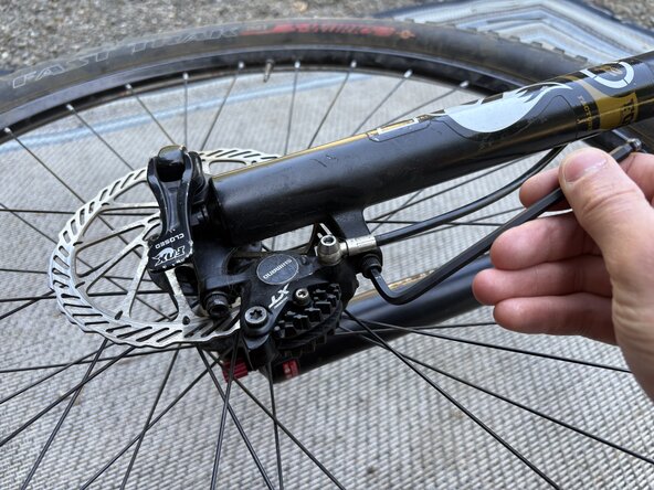

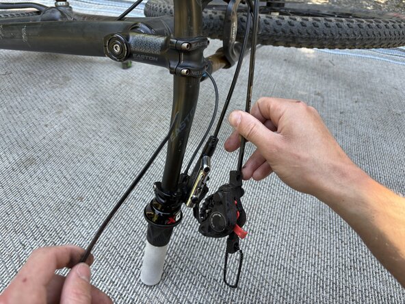

  7. Fox32 Mountain Bike Front Air Suspension Fork Seal and Oil Replacement: étape 7, image 1 de 3 Fox32 Mountain Bike Front Air Suspension Fork Seal and Oil Replacement: étape 7, image 2 de 3 Fox32 Mountain Bike Front Air Suspension Fork Seal and Oil Replacement: étape 7, image 3 de 3
    • Use a zip tie to secure the brake caliper to the handle bars.
    • This step will ensure the brake caliper does not move around excessively and stress the brake line.
    Demander à FixBot

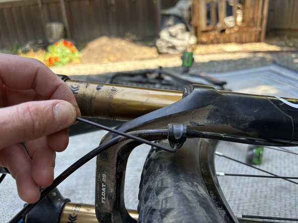

  8. Fox32 Mountain Bike Front Air Suspension Fork Seal and Oil Replacement: étape 8, image 1 de 3 Fox32 Mountain Bike Front Air Suspension Fork Seal and Oil Replacement: étape 8, image 2 de 3 Fox32 Mountain Bike Front Air Suspension Fork Seal and Oil Replacement: étape 8, image 3 de 3
    • Find the correct Allen key to remove the brake line bracket from the fork.
    • Remove by turning the bolt counter clockwise.
    • After the brake line is removed from the bracket, screw the bracket back onto the fork.

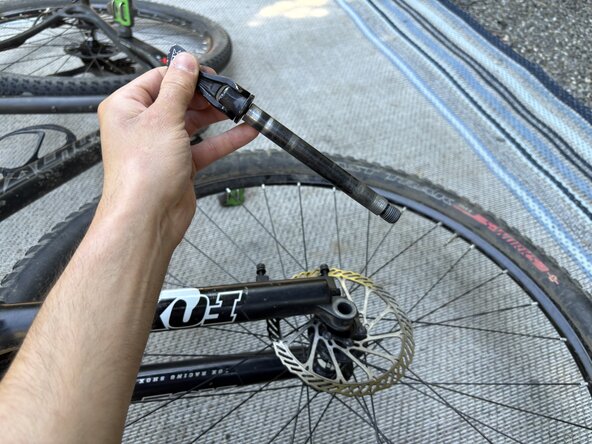

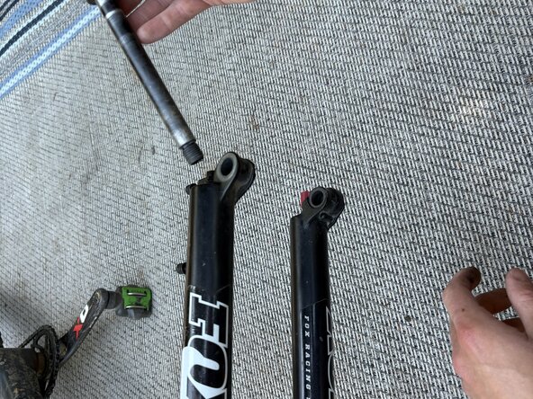

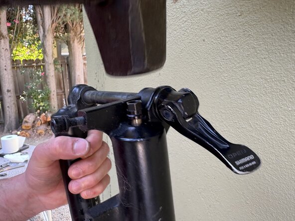

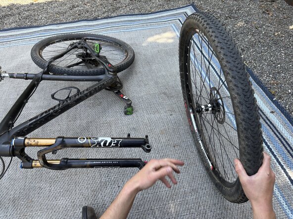

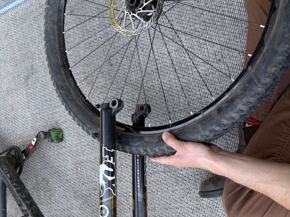

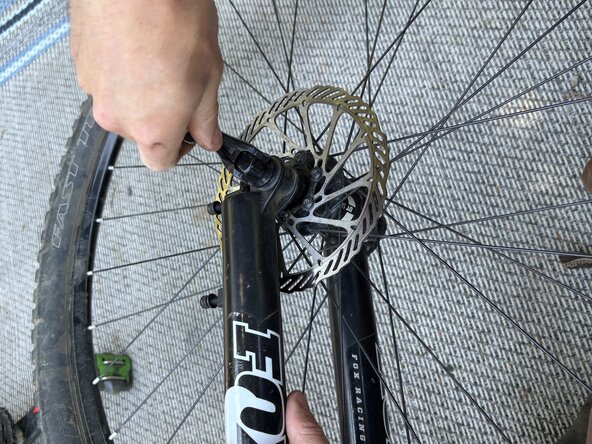

  9. Fox32 Mountain Bike Front Air Suspension Fork Seal and Oil Replacement: étape 9, image 1 de 3 Fox32 Mountain Bike Front Air Suspension Fork Seal and Oil Replacement: étape 9, image 2 de 3 Fox32 Mountain Bike Front Air Suspension Fork Seal and Oil Replacement: étape 9, image 3 de 3
    • Remove the thru-axle by flipping the lever down and unscrewing counter clockwise.
    Demander à FixBot
  10. Fox32 Mountain Bike Front Air Suspension Fork Seal and Oil Replacement: étape 10, image 1 de 3 Fox32 Mountain Bike Front Air Suspension Fork Seal and Oil Replacement: étape 10, image 2 de 3 Fox32 Mountain Bike Front Air Suspension Fork Seal and Oil Replacement: étape 10, image 3 de 3
    • Remove the wheel from the fork.
    • Set aside for safe keeping.
    Demander à FixBot
  11. Fox32 Mountain Bike Front Air Suspension Fork Seal and Oil Replacement: étape 11, image 1 de 3 Fox32 Mountain Bike Front Air Suspension Fork Seal and Oil Replacement: étape 11, image 2 de 3 Fox32 Mountain Bike Front Air Suspension Fork Seal and Oil Replacement: étape 11, image 3 de 3
    • Reinsert the thru-axle into the fork for safe keeping.
    Demander à FixBot

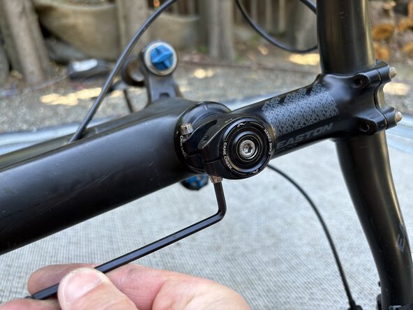

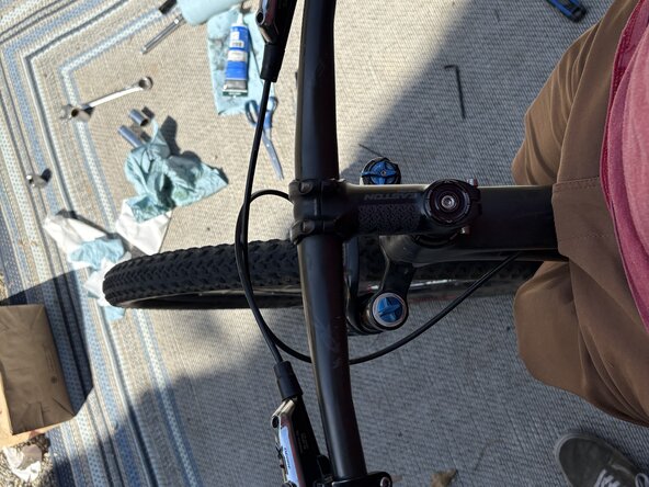

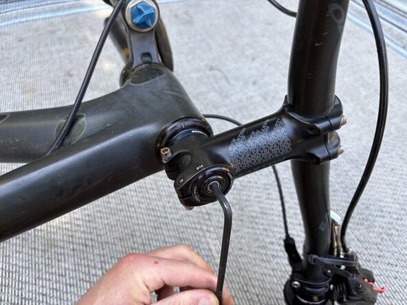

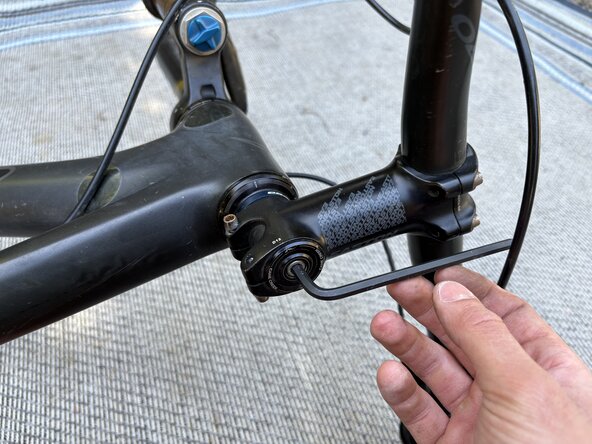

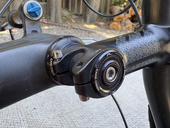

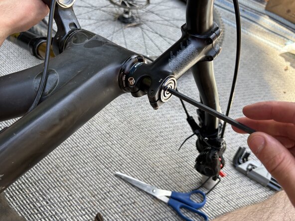

  12. Fox32 Mountain Bike Front Air Suspension Fork Seal and Oil Replacement: étape 12, image 1 de 3 Fox32 Mountain Bike Front Air Suspension Fork Seal and Oil Replacement: étape 12, image 2 de 3 Fox32 Mountain Bike Front Air Suspension Fork Seal and Oil Replacement: étape 12, image 3 de 3
    • Find the proper sized Allen key to loosen the stem clamp bolts.
    • Loosen each stem bolt at least 3 turns by turning counter clock wise.
    • Do not remove the bolts entirely.
    Demander à FixBot
  13. Fox32 Mountain Bike Front Air Suspension Fork Seal and Oil Replacement: étape 13, image 1 de 3 Fox32 Mountain Bike Front Air Suspension Fork Seal and Oil Replacement: étape 13, image 2 de 3 Fox32 Mountain Bike Front Air Suspension Fork Seal and Oil Replacement: étape 13, image 3 de 3
    • Loosen the second stem bolt by turning counter clockwise at least 3 turns
    Demander à FixBot

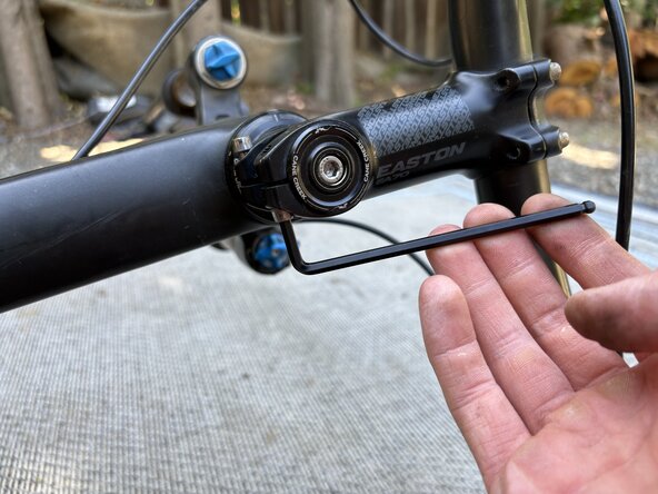

  14. Fox32 Mountain Bike Front Air Suspension Fork Seal and Oil Replacement: étape 14, image 1 de 3 Fox32 Mountain Bike Front Air Suspension Fork Seal and Oil Replacement: étape 14, image 2 de 3 Fox32 Mountain Bike Front Air Suspension Fork Seal and Oil Replacement: étape 14, image 3 de 3
    • Find the appropriate sized Allen key to fit the stem bolt.
    • Remove the stem cap by turning the bolt counter clockwise.
    Demander à FixBot

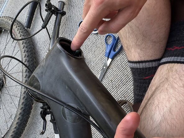

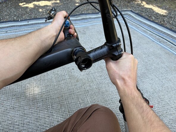

  15. Fox32 Mountain Bike Front Air Suspension Fork Seal and Oil Replacement: étape 15, image 1 de 3 Fox32 Mountain Bike Front Air Suspension Fork Seal and Oil Replacement: étape 15, image 2 de 3 Fox32 Mountain Bike Front Air Suspension Fork Seal and Oil Replacement: étape 15, image 3 de 3
    • Slide the stem off the steer tube.
    Demander à FixBot

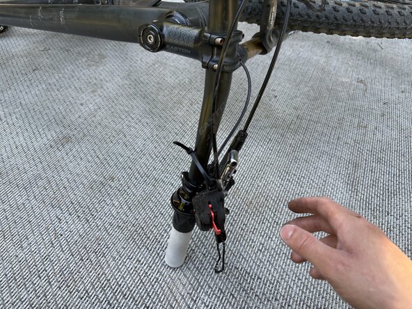

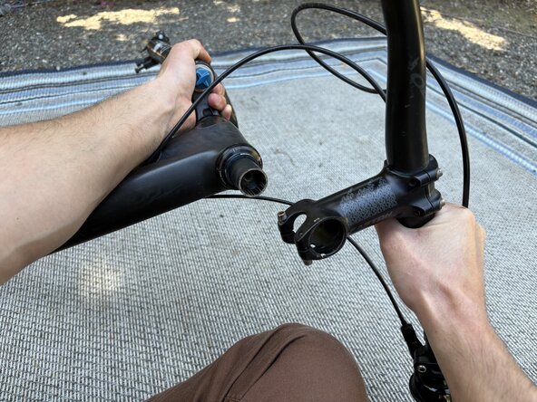

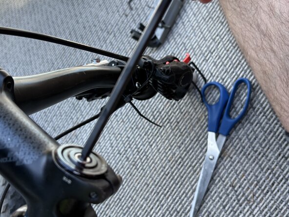

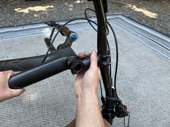

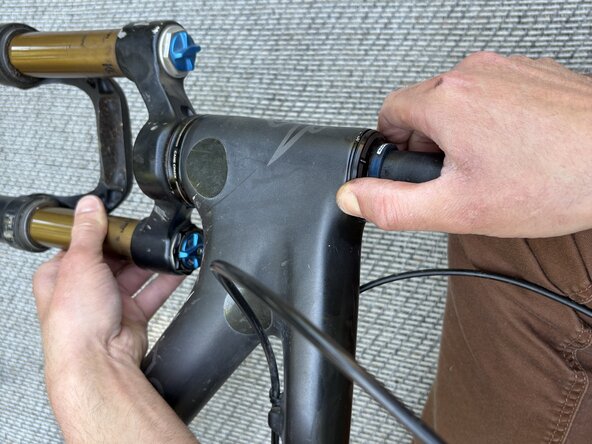

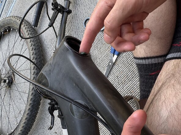

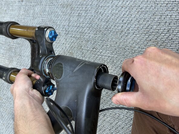

  16. Fox32 Mountain Bike Front Air Suspension Fork Seal and Oil Replacement: étape 16, image 1 de 3 Fox32 Mountain Bike Front Air Suspension Fork Seal and Oil Replacement: étape 16, image 2 de 3 Fox32 Mountain Bike Front Air Suspension Fork Seal and Oil Replacement: étape 16, image 3 de 3
    • Begin to slide the steer tube out of the frame.
    Demander à FixBot

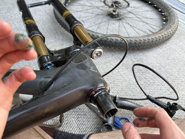

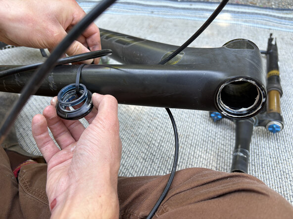

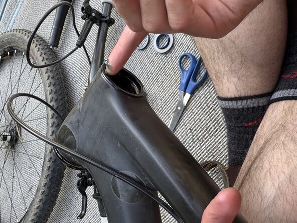

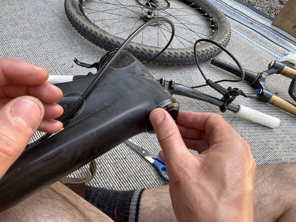

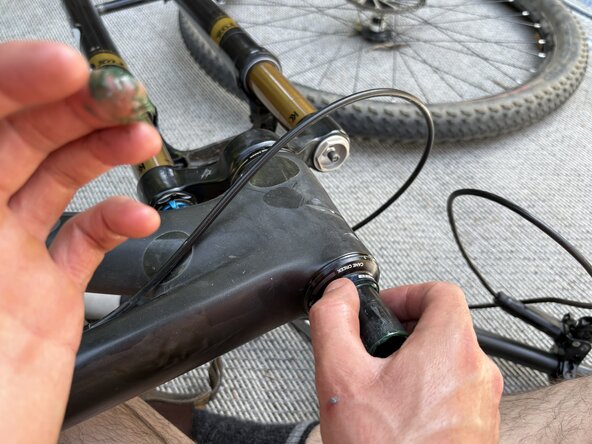

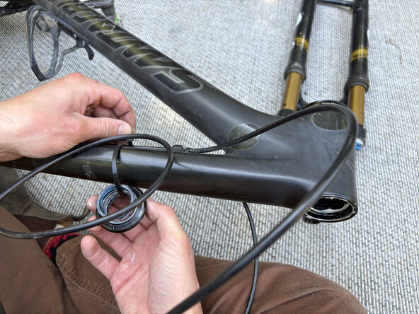

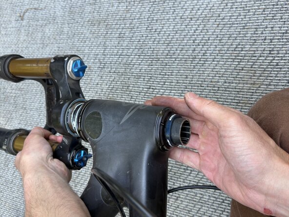

  17. Fox32 Mountain Bike Front Air Suspension Fork Seal and Oil Replacement: étape 17, image 1 de 3 Fox32 Mountain Bike Front Air Suspension Fork Seal and Oil Replacement: étape 17, image 2 de 3 Fox32 Mountain Bike Front Air Suspension Fork Seal and Oil Replacement: étape 17, image 3 de 3
    • Remove the upper portion of the headset.
    Demander à FixBot

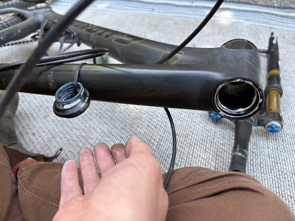

  18. Fox32 Mountain Bike Front Air Suspension Fork Seal and Oil Replacement: étape 18, image 1 de 3 Fox32 Mountain Bike Front Air Suspension Fork Seal and Oil Replacement: étape 18, image 2 de 3 Fox32 Mountain Bike Front Air Suspension Fork Seal and Oil Replacement: étape 18, image 3 de 3
    • Zip tie the headset components to the frame for safe keeping.
    Demander à FixBot

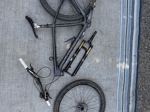

  19. Fox32 Mountain Bike Front Air Suspension Fork Seal and Oil Replacement: étape 19, image 1 de 1
    • This is all the disassembly that should have been done. Keep everything organized for easy assembly!
    Demander à FixBot

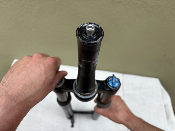

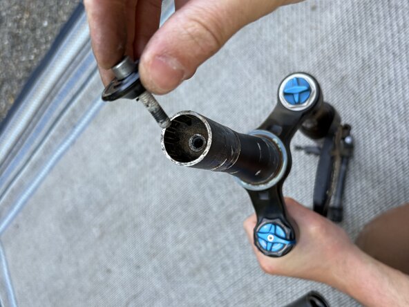

  20. Fox32 Mountain Bike Front Air Suspension Fork Seal and Oil Replacement: étape 20, image 1 de 3 Fox32 Mountain Bike Front Air Suspension Fork Seal and Oil Replacement: étape 20, image 2 de 3 Fox32 Mountain Bike Front Air Suspension Fork Seal and Oil Replacement: étape 20, image 3 de 3
    • Screw the top cap back into the steer tube on the fork for safe keeping.

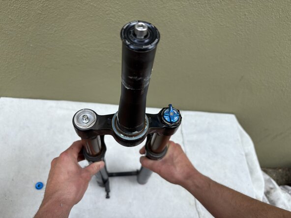

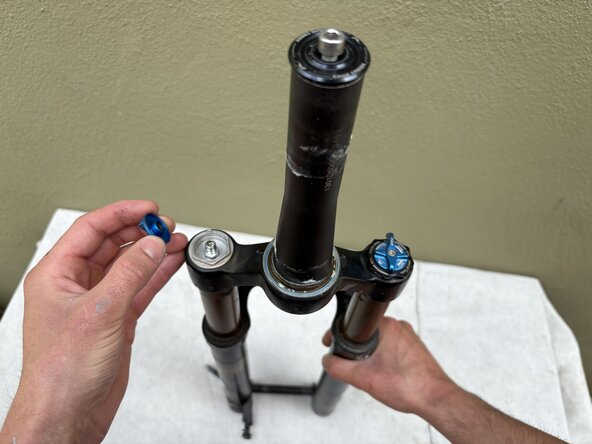

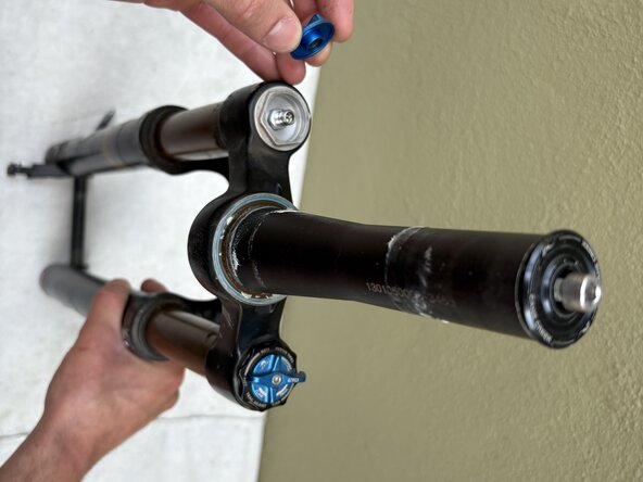

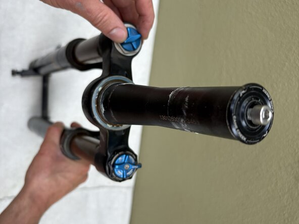

  21. Fox32 Mountain Bike Front Air Suspension Fork Seal and Oil Replacement: étape 21, image 1 de 3 Fox32 Mountain Bike Front Air Suspension Fork Seal and Oil Replacement: étape 21, image 2 de 3 Fox32 Mountain Bike Front Air Suspension Fork Seal and Oil Replacement: étape 21, image 3 de 3
    • Remove the cap on the left side of the fork by turning counter clockwise, exposing an air valve.
    Demander à FixBot

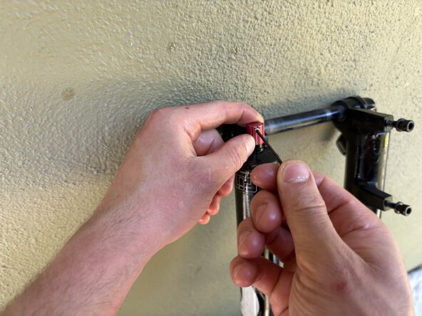

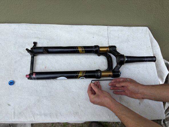

  22. Fox32 Mountain Bike Front Air Suspension Fork Seal and Oil Replacement: étape 22, image 1 de 3 Fox32 Mountain Bike Front Air Suspension Fork Seal and Oil Replacement: étape 22, image 2 de 3 Fox32 Mountain Bike Front Air Suspension Fork Seal and Oil Replacement: étape 22, image 3 de 3
    • Use a small allen key (2.5mm was used in this case) to release all of the air from the fork.
    • Notice how the fork compresses when all the air has been released.
    Demander à FixBot

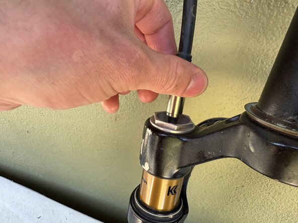

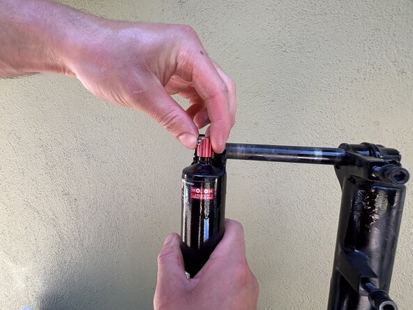

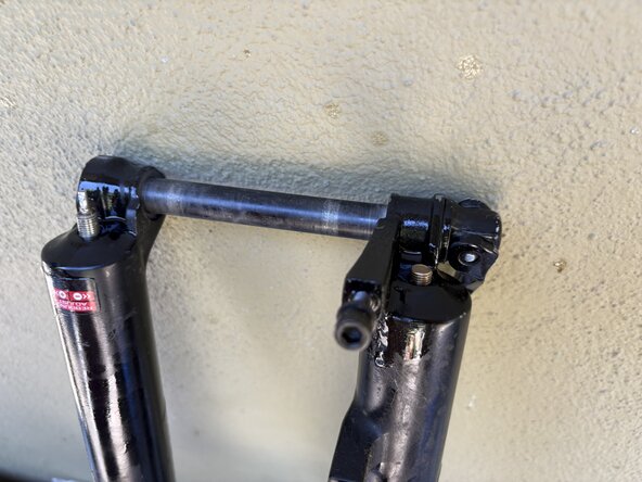

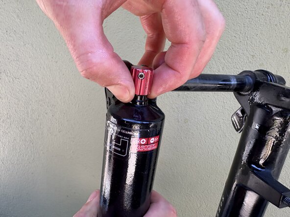

  23. Fox32 Mountain Bike Front Air Suspension Fork Seal and Oil Replacement: étape 23, image 1 de 3 Fox32 Mountain Bike Front Air Suspension Fork Seal and Oil Replacement: étape 23, image 2 de 3 Fox32 Mountain Bike Front Air Suspension Fork Seal and Oil Replacement: étape 23, image 3 de 3
    • On a work surface, flip the fork upside down and locate the red rebound knob.
    • Locate the small allen bolt and find the appropriate sized allen key. Loosen the bolt by turning counter clockwise 3 rotations and remove the rebound knob.
    Demander à FixBot

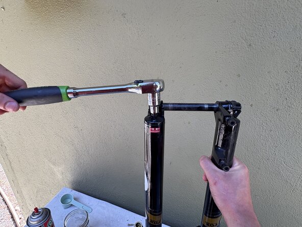

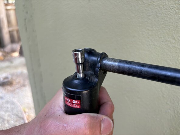

  24. Fox32 Mountain Bike Front Air Suspension Fork Seal and Oil Replacement: étape 24, image 1 de 3 Fox32 Mountain Bike Front Air Suspension Fork Seal and Oil Replacement: étape 24, image 2 de 3 Fox32 Mountain Bike Front Air Suspension Fork Seal and Oil Replacement: étape 24, image 3 de 3
    • Find the appropriate sized hex socket to fit the nut that is under the rebound knob. Remove by turning counter clockwise.
    • Note: Keep in mind a long socket handle may make removal easier.
    Demander à FixBot

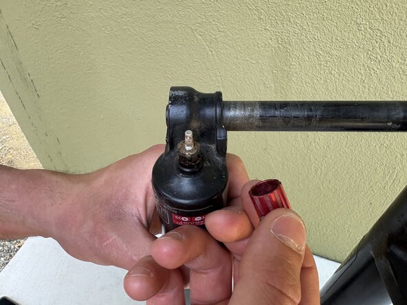

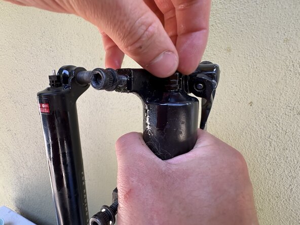

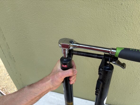

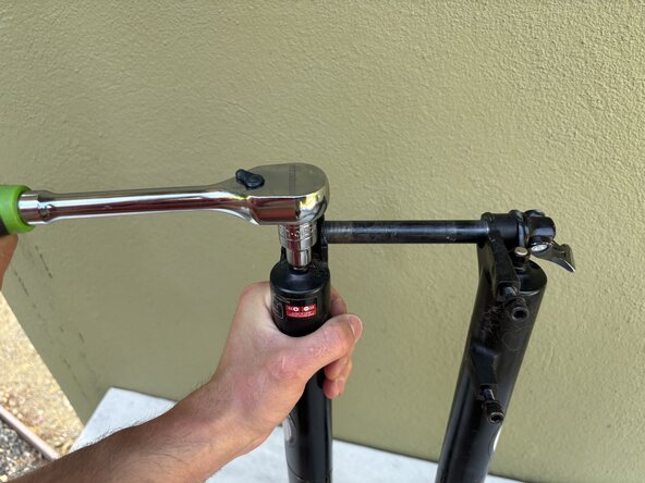

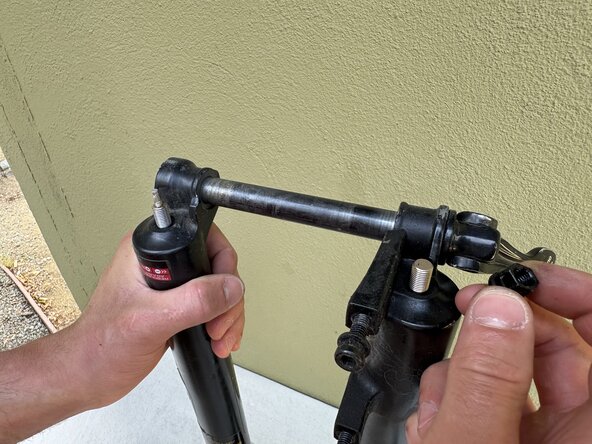

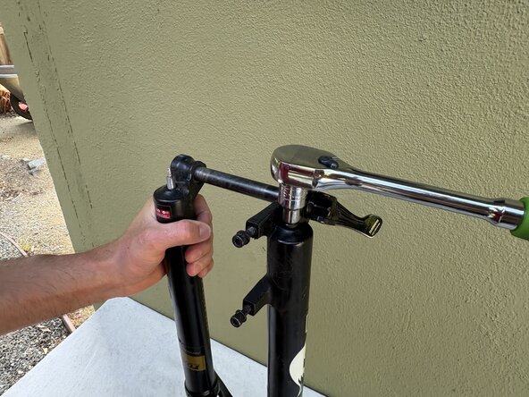

  25. Fox32 Mountain Bike Front Air Suspension Fork Seal and Oil Replacement: étape 25, image 1 de 3 Fox32 Mountain Bike Front Air Suspension Fork Seal and Oil Replacement: étape 25, image 2 de 3 Fox32 Mountain Bike Front Air Suspension Fork Seal and Oil Replacement: étape 25, image 3 de 3
    • Remove the nut on the bottom of the other stanchion using the same process.
    • The nut size should be the same.
    Demander à FixBot

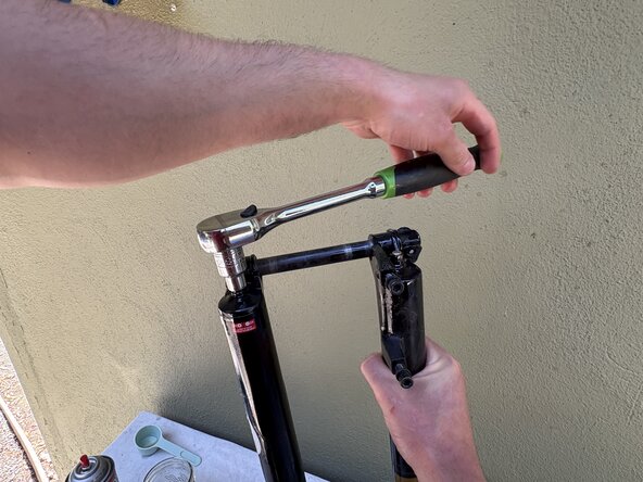

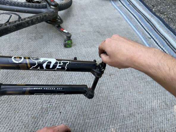

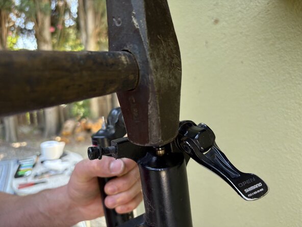

  26. Fox32 Mountain Bike Front Air Suspension Fork Seal and Oil Replacement: étape 26, image 1 de 2 Fox32 Mountain Bike Front Air Suspension Fork Seal and Oil Replacement: étape 26, image 2 de 2
    • Find a small socket that will rest on the shoulder below the threads but not damage the threads on the rebound side of the fork.
    • Use a soft headed mallet to lightly tap on the socket.
    Demander à FixBot
  27. Fox32 Mountain Bike Front Air Suspension Fork Seal and Oil Replacement: étape 27, image 1 de 3 Fox32 Mountain Bike Front Air Suspension Fork Seal and Oil Replacement: étape 27, image 2 de 3 Fox32 Mountain Bike Front Air Suspension Fork Seal and Oil Replacement: étape 27, image 3 de 3
    • Screw the nut part way onto the threads on the other side.
    • Use a soft headed mallet and lightly tap on the nut.
    • Remove the nut and socket from the threaded parts of the fork.
    • Keep the fork inverted for the entirety of this step.
    Demander à FixBot

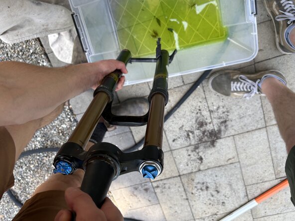

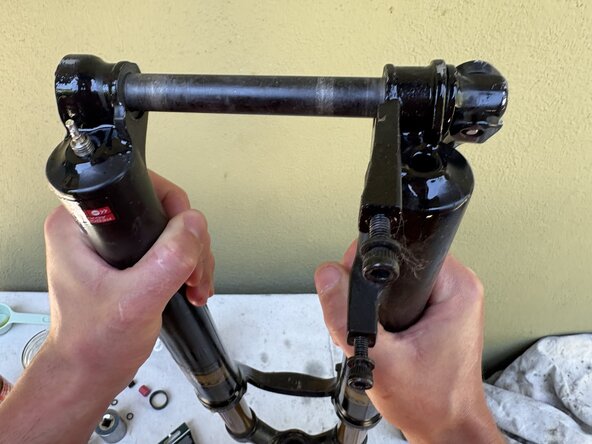

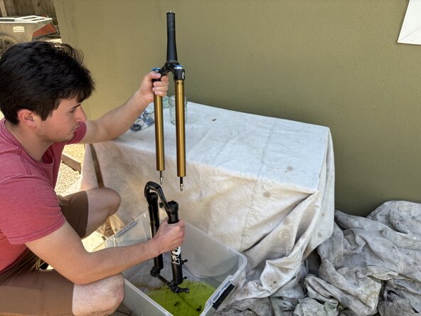

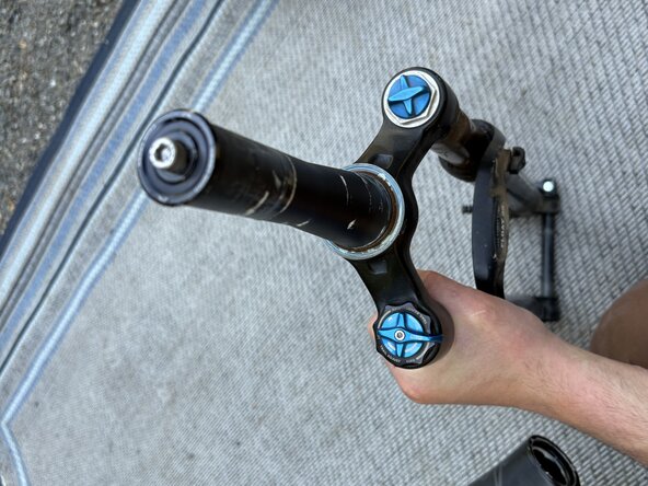

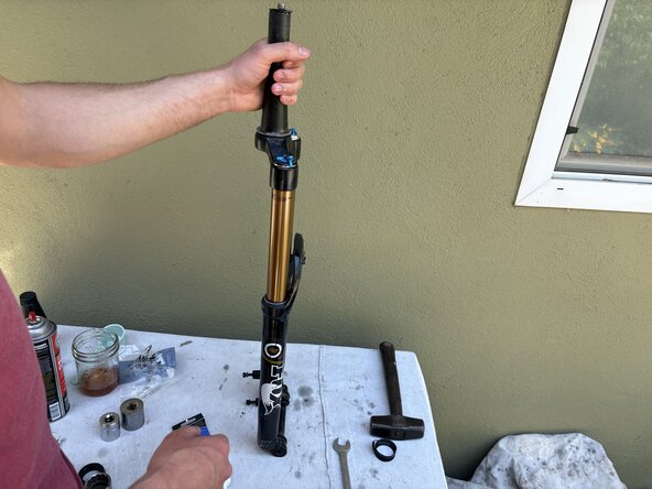

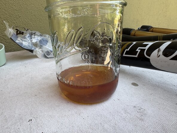

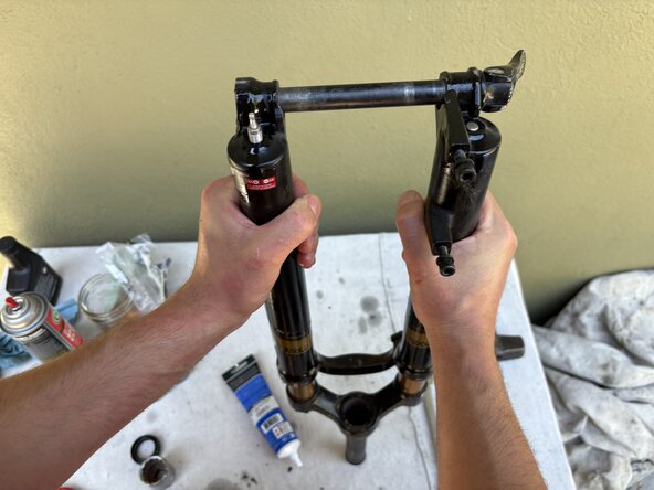

  28. Fox32 Mountain Bike Front Air Suspension Fork Seal and Oil Replacement: étape 28, image 1 de 3 Fox32 Mountain Bike Front Air Suspension Fork Seal and Oil Replacement: étape 28, image 2 de 3 Fox32 Mountain Bike Front Air Suspension Fork Seal and Oil Replacement: étape 28, image 3 de 3
    • Get a large container to capture the oil inside the fork.
    • Flip the fork over above the large container, keeping in mind that oil will begin to flow out once the fork is turned right side up.
    • Hold the fork above this container and slide the stanchions out of the fork body.
    Demander à FixBot

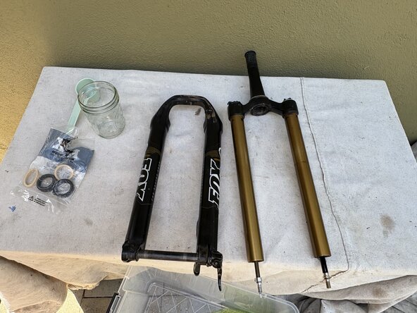

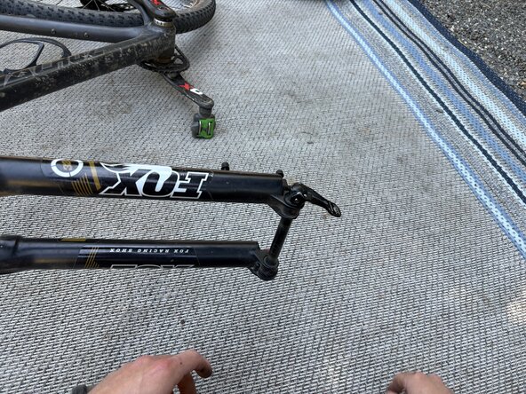

  29. Fox32 Mountain Bike Front Air Suspension Fork Seal and Oil Replacement: étape 29, image 1 de 1
    • The stanchions should now be separated from the fork.
    Demander à FixBot

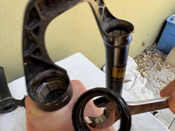

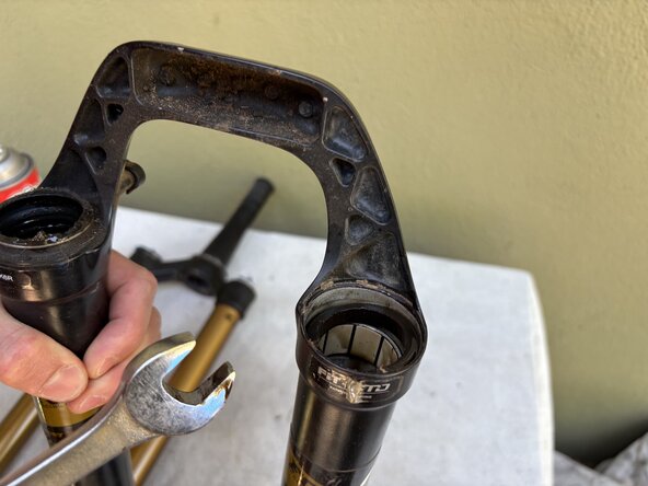

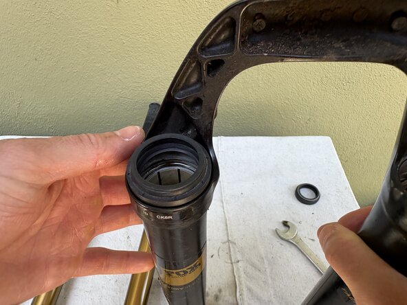

  30. Fox32 Mountain Bike Front Air Suspension Fork Seal and Oil Replacement: étape 30, image 1 de 3 Fox32 Mountain Bike Front Air Suspension Fork Seal and Oil Replacement: étape 30, image 2 de 3 Fox32 Mountain Bike Front Air Suspension Fork Seal and Oil Replacement: étape 30, image 3 de 3
    • Use a flat wrench to pry the dust seals out of the fork body.
    • Be very careful to not scratch the inside of the fork body with the wrench.
    Demander à FixBot

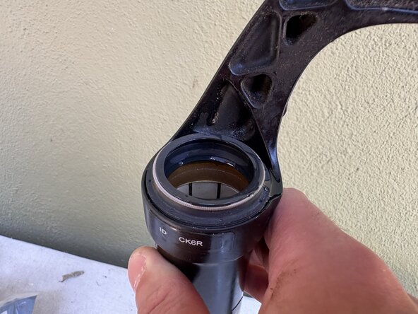

    • Perform this step on the other side of the fork body.
    Demander à FixBot

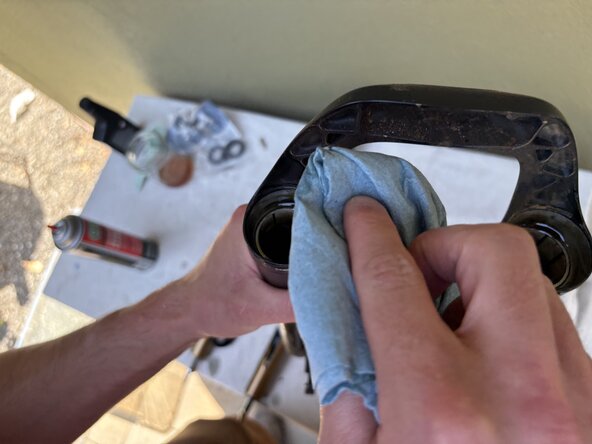

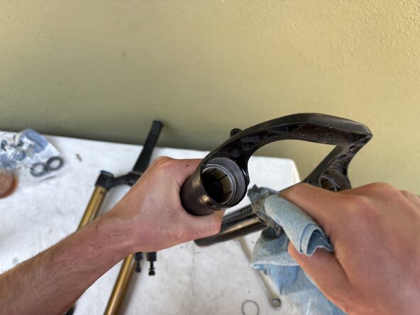

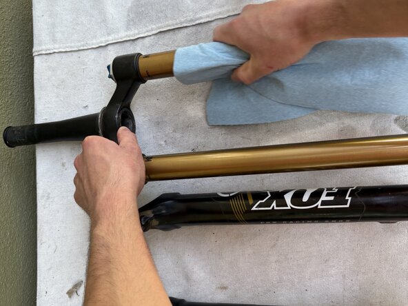

  32. Fox32 Mountain Bike Front Air Suspension Fork Seal and Oil Replacement: étape 32, image 1 de 3 Fox32 Mountain Bike Front Air Suspension Fork Seal and Oil Replacement: étape 32, image 2 de 3 Fox32 Mountain Bike Front Air Suspension Fork Seal and Oil Replacement: étape 32, image 3 de 3

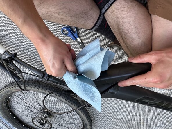

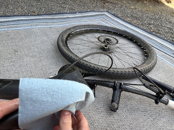

    • Use a rag to clean the surface that the dust seal sits on.
    • There is likely lots of dust on and around this surface, so wipe it down well.
    Demander à FixBot

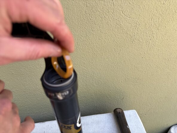

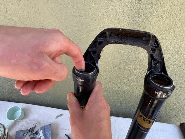

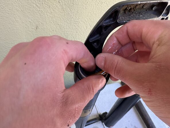

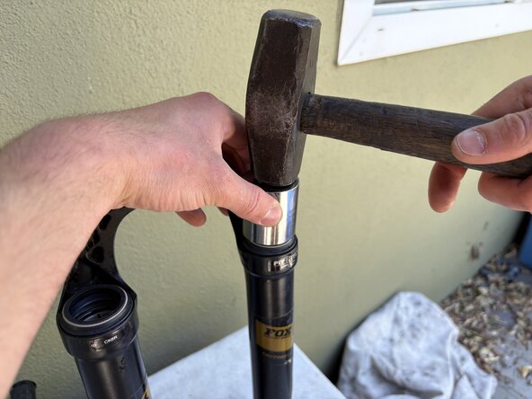

  33. Fox32 Mountain Bike Front Air Suspension Fork Seal and Oil Replacement: étape 33, image 1 de 3 Fox32 Mountain Bike Front Air Suspension Fork Seal and Oil Replacement: étape 33, image 2 de 3 Fox32 Mountain Bike Front Air Suspension Fork Seal and Oil Replacement: étape 33, image 3 de 3
    • Rest the new dust seal over where the old one was removed.
    • The metal ring should be facing down.
    • Use a socket the same diameter of the dust seal and a mallet to seat the dust seals.
    • Be very gentle and do not damage the dust seals. It may take several small taps.
    Demander à FixBot

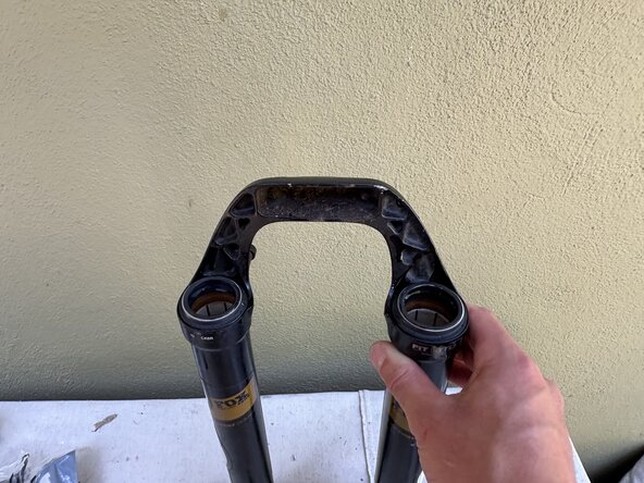

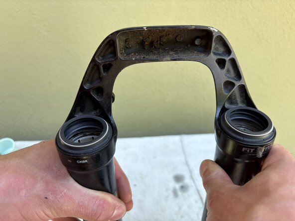

  34. Fox32 Mountain Bike Front Air Suspension Fork Seal and Oil Replacement: étape 34, image 1 de 1
    • Both dust seals should now be seated in the fork body.
    Demander à FixBot

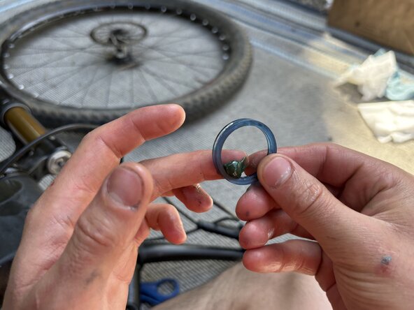

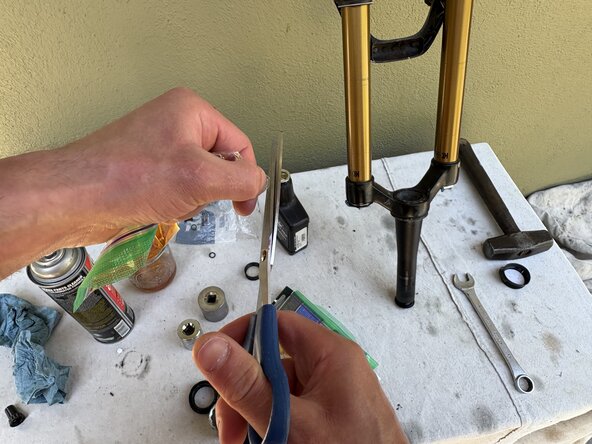

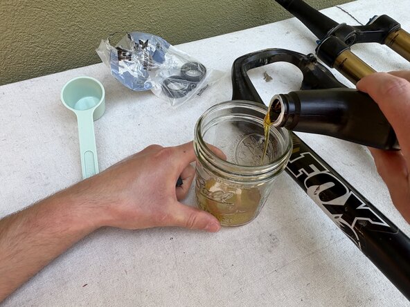

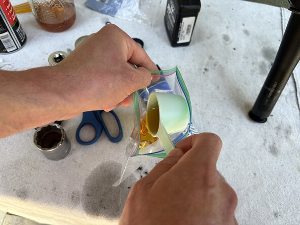

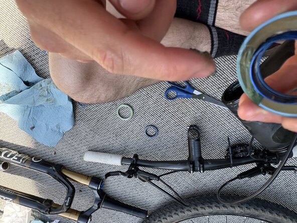

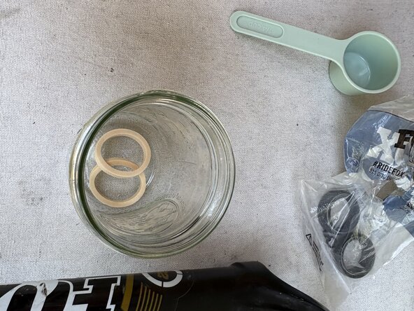

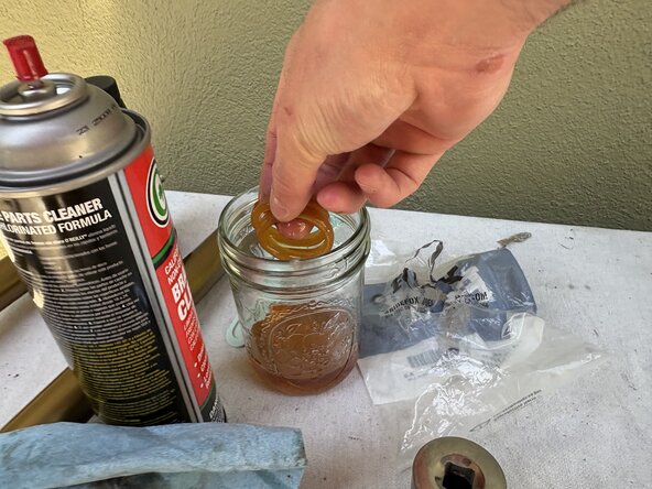

  35. Fox32 Mountain Bike Front Air Suspension Fork Seal and Oil Replacement: étape 35, image 1 de 3 Fox32 Mountain Bike Front Air Suspension Fork Seal and Oil Replacement: étape 35, image 2 de 3 Fox32 Mountain Bike Front Air Suspension Fork Seal and Oil Replacement: étape 35, image 3 de 3
    • Soak the white bushings in fork oil.
    • Pour enough oil to cover the bushings
    Demander à FixBot

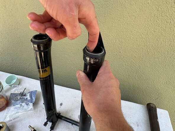

  36. Fox32 Mountain Bike Front Air Suspension Fork Seal and Oil Replacement: étape 36, image 1 de 3 Fox32 Mountain Bike Front Air Suspension Fork Seal and Oil Replacement: étape 36, image 2 de 3 Fox32 Mountain Bike Front Air Suspension Fork Seal and Oil Replacement: étape 36, image 3 de 3
    • After letting the bushings soak for ~5 minutes, insert them into the dust wipers.
    • They should easily seat in place. The oil will help keep a seal and provide lubrication.
    Demander à FixBot
  37. Fox32 Mountain Bike Front Air Suspension Fork Seal and Oil Replacement: étape 37, image 1 de 3 Fox32 Mountain Bike Front Air Suspension Fork Seal and Oil Replacement: étape 37, image 2 de 3 Fox32 Mountain Bike Front Air Suspension Fork Seal and Oil Replacement: étape 37, image 3 de 3
    • This is now how the dust seals should look.
    Demander à FixBot

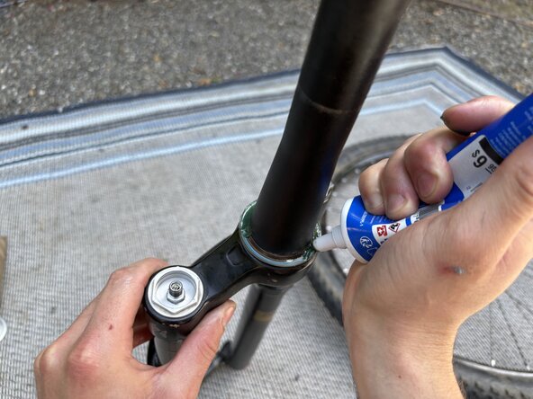

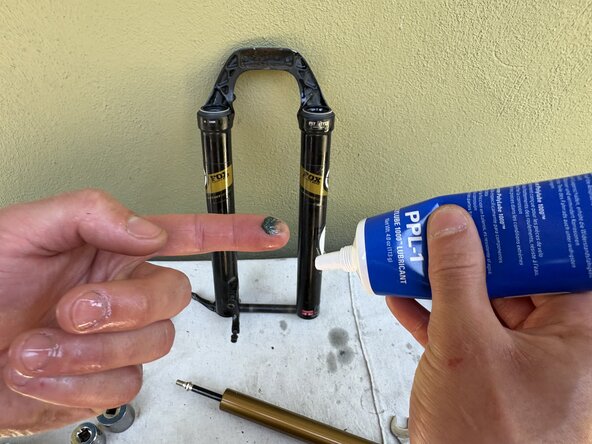

  38. Fox32 Mountain Bike Front Air Suspension Fork Seal and Oil Replacement: étape 38, image 1 de 3 Fox32 Mountain Bike Front Air Suspension Fork Seal and Oil Replacement: étape 38, image 2 de 3 Fox32 Mountain Bike Front Air Suspension Fork Seal and Oil Replacement: étape 38, image 3 de 3
    • Apply a small drop of grease to the inside of each dust seal.
    Demander à FixBot

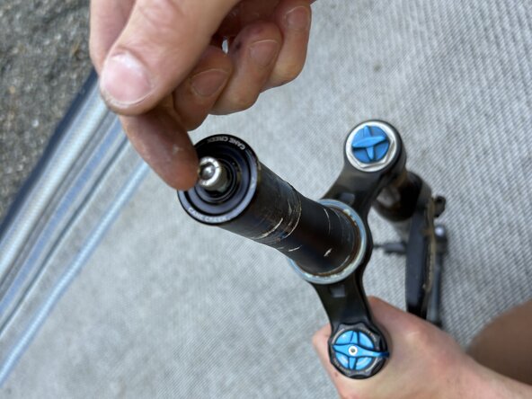

  40. Fox32 Mountain Bike Front Air Suspension Fork Seal and Oil Replacement: étape 40, image 1 de 3 Fox32 Mountain Bike Front Air Suspension Fork Seal and Oil Replacement: étape 40, image 2 de 3 Fox32 Mountain Bike Front Air Suspension Fork Seal and Oil Replacement: étape 40, image 3 de 3
    • Be sure the rods in the bottom of the stanchions are fully extended.
    Demander à FixBot
  41. Fox32 Mountain Bike Front Air Suspension Fork Seal and Oil Replacement: étape 41, image 1 de 2 Fox32 Mountain Bike Front Air Suspension Fork Seal and Oil Replacement: étape 41, image 2 de 2
    • Insert the fork stanchions into the fork body part way.
    • Do not fully insert.
    Demander à FixBot

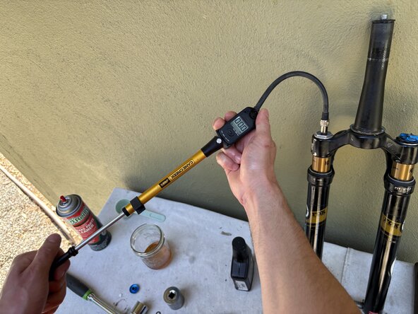

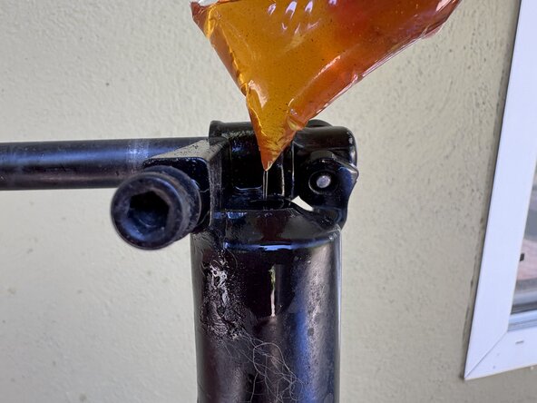

  42. Fox32 Mountain Bike Front Air Suspension Fork Seal and Oil Replacement: étape 42, image 1 de 3 Fox32 Mountain Bike Front Air Suspension Fork Seal and Oil Replacement: étape 42, image 2 de 3 Fox32 Mountain Bike Front Air Suspension Fork Seal and Oil Replacement: étape 42, image 3 de 3
    • Using the serial number on your fork, determine from the manufacturer website how much oil should be added to each side of the fork.
    • In this case, it was 30 mL total.
    • Dump the measured quantity of oil into a plastic bag. Close the bag, invert, and cut a small part of a corner off.
    Demander à FixBot
  43. Fox32 Mountain Bike Front Air Suspension Fork Seal and Oil Replacement: étape 43, image 1 de 3 Fox32 Mountain Bike Front Air Suspension Fork Seal and Oil Replacement: étape 43, image 2 de 3 Fox32 Mountain Bike Front Air Suspension Fork Seal and Oil Replacement: étape 43, image 3 de 3
    • Pipe the fluid into the bottom of the fork body.
    • This fork used an equal amount of oil for each side. If the manufacturer recommends a different amount of oil for each side, it may be wise to measure and pipe oil into each side separately.

  44. Fox32 Mountain Bike Front Air Suspension Fork Seal and Oil Replacement: étape 44, image 1 de 2 Fox32 Mountain Bike Front Air Suspension Fork Seal and Oil Replacement: étape 44, image 2 de 2
    • Compress the fork enough for the threaded nipples to come through the bottom of the fork.
    • Keep the fork inverted for the remainder of the assembly.
    Demander à FixBot
  45. Fox32 Mountain Bike Front Air Suspension Fork Seal and Oil Replacement: étape 45, image 1 de 3 Fox32 Mountain Bike Front Air Suspension Fork Seal and Oil Replacement: étape 45, image 2 de 3 Fox32 Mountain Bike Front Air Suspension Fork Seal and Oil Replacement: étape 45, image 3 de 3
    • Thread the nut onto each nipple by hand.
    Demander à FixBot
  46. Fox32 Mountain Bike Front Air Suspension Fork Seal and Oil Replacement: étape 46, image 1 de 3 Fox32 Mountain Bike Front Air Suspension Fork Seal and Oil Replacement: étape 46, image 2 de 3 Fox32 Mountain Bike Front Air Suspension Fork Seal and Oil Replacement: étape 46, image 3 de 3
    • Use a socket to tighten each nut.
    • They should be tight, but do not need to be cranked down.
    Demander à FixBot
  47. Fox32 Mountain Bike Front Air Suspension Fork Seal and Oil Replacement: étape 47, image 1 de 3 Fox32 Mountain Bike Front Air Suspension Fork Seal and Oil Replacement: étape 47, image 2 de 3 Fox32 Mountain Bike Front Air Suspension Fork Seal and Oil Replacement: étape 47, image 3 de 3
    • Reinstall the rebound knob.
    • Turn the Allen bolt clockwise to secure the knob.
    Demander à FixBot
  48. Fox32 Mountain Bike Front Air Suspension Fork Seal and Oil Replacement: étape 48, image 1 de 3 Fox32 Mountain Bike Front Air Suspension Fork Seal and Oil Replacement: étape 48, image 2 de 3 Fox32 Mountain Bike Front Air Suspension Fork Seal and Oil Replacement: étape 48, image 3 de 3
    • At this point, the fork can be turned right side up.
    • Unscrew the cap covering the air input (opposite side from the damper).
    Demander à FixBot
  49. Fox32 Mountain Bike Front Air Suspension Fork Seal and Oil Replacement: étape 49, image 1 de 3 Fox32 Mountain Bike Front Air Suspension Fork Seal and Oil Replacement: étape 49, image 2 de 3 Fox32 Mountain Bike Front Air Suspension Fork Seal and Oil Replacement: étape 49, image 3 de 3
    • Use a shock pump to air the fork to the desired pressure.
    • As a rule of thumb, this should be about 50% of rider weight in PSI. Consult the manufacturer website or manual for a more precise value.

  50. Fox32 Mountain Bike Front Air Suspension Fork Seal and Oil Replacement: étape 50, image 1 de 3 Fox32 Mountain Bike Front Air Suspension Fork Seal and Oil Replacement: étape 50, image 2 de 3 Fox32 Mountain Bike Front Air Suspension Fork Seal and Oil Replacement: étape 50, image 3 de 3
    • Clean the inside of the head tube using a clean rag.
    • Be sure to remove as much old grease as possible.
    Demander à FixBot
  51. Fox32 Mountain Bike Front Air Suspension Fork Seal and Oil Replacement: étape 51, image 1 de 3 Fox32 Mountain Bike Front Air Suspension Fork Seal and Oil Replacement: étape 51, image 2 de 3 Fox32 Mountain Bike Front Air Suspension Fork Seal and Oil Replacement: étape 51, image 3 de 3
    • Apply a drop of grease to the inside of the head tube.
    Demander à FixBot
  52. Fox32 Mountain Bike Front Air Suspension Fork Seal and Oil Replacement: étape 52, image 1 de 2 Fox32 Mountain Bike Front Air Suspension Fork Seal and Oil Replacement: étape 52, image 2 de 2
    • Regrease the head set component removed earlier.
    Demander à FixBot
  53. Fox32 Mountain Bike Front Air Suspension Fork Seal and Oil Replacement: étape 53, image 1 de 3 Fox32 Mountain Bike Front Air Suspension Fork Seal and Oil Replacement: étape 53, image 2 de 3 Fox32 Mountain Bike Front Air Suspension Fork Seal and Oil Replacement: étape 53, image 3 de 3
    • Reinsert the headset component back into the frame.
    Demander à FixBot
  54. Fox32 Mountain Bike Front Air Suspension Fork Seal and Oil Replacement: étape 54, image 1 de 3 Fox32 Mountain Bike Front Air Suspension Fork Seal and Oil Replacement: étape 54, image 2 de 3 Fox32 Mountain Bike Front Air Suspension Fork Seal and Oil Replacement: étape 54, image 3 de 3
    • Grease the headset component in the bottom of the head tube, and the base of the steer tube.
    Demander à FixBot
  55. Fox32 Mountain Bike Front Air Suspension Fork Seal and Oil Replacement: étape 55, image 1 de 3 Fox32 Mountain Bike Front Air Suspension Fork Seal and Oil Replacement: étape 55, image 2 de 3 Fox32 Mountain Bike Front Air Suspension Fork Seal and Oil Replacement: étape 55, image 3 de 3
    • Insert the fork back into the frame.
    • Be careful when reinstalling so that no parts of the headset assembly are knocked off during reassembly.
    Demander à FixBot

  57. Fox32 Mountain Bike Front Air Suspension Fork Seal and Oil Replacement: étape 57, image 1 de 3 Fox32 Mountain Bike Front Air Suspension Fork Seal and Oil Replacement: étape 57, image 2 de 3 Fox32 Mountain Bike Front Air Suspension Fork Seal and Oil Replacement: étape 57, image 3 de 3
    • Reinsert the stem spacer onto the steer tube.
    • From here on, assembly is the reverse of disassembly.
    Demander à FixBot
  58. Fox32 Mountain Bike Front Air Suspension Fork Seal and Oil Replacement: étape 58, image 1 de 3 Fox32 Mountain Bike Front Air Suspension Fork Seal and Oil Replacement: étape 58, image 2 de 3 Fox32 Mountain Bike Front Air Suspension Fork Seal and Oil Replacement: étape 58, image 3 de 3
    • When reinstalling the handlebars, ensure they are aligned with the front wheel. This is best done by standing over the bike and looking down on the handlebars and wheels.
    Demander à FixBot
