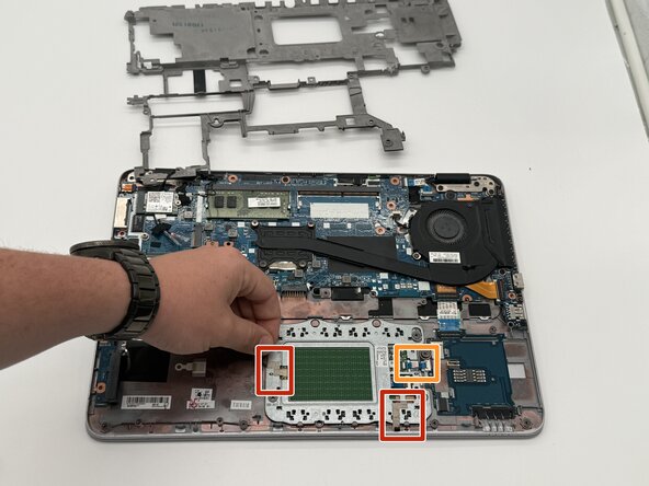

  4. HP EliteBook 840 G4 Trackpad Replacement: étape 4, image 1 de 1
    • Remove the tape from the trackpad.
    • Disconnect the blue cable.
    Demander à FixBot
    Ajouter un commentaire
  5. HP EliteBook 840 G4 Trackpad Replacement: étape 5, image 1 de 2 HP EliteBook 840 G4 Trackpad Replacement: étape 5, image 2 de 2
    • Pick up the far side of the trackpad and slide it up and out away from you to disconnect it.
