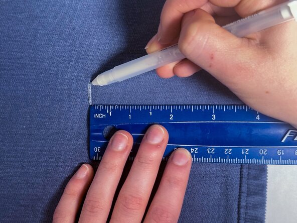

    3. Hand-Hemming Flare Corduroy Pants: étape 3, image 1 de 2 Hand-Hemming Flare Corduroy Pants: étape 3, image 2 de 2
      • Measure the distance with a ruler from the original hem to the pin.
      • Mark your new hemline with the white pen and remove the pin.

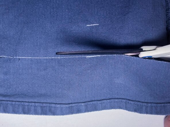

    6. Hand-Hemming Flare Corduroy Pants: étape 6, image 1 de 2 Hand-Hemming Flare Corduroy Pants: étape 6, image 2 de 2
      • Cut off the excess fabric below this new line.
      • This step will permanently shorten your pants; measure carefully before cutting.

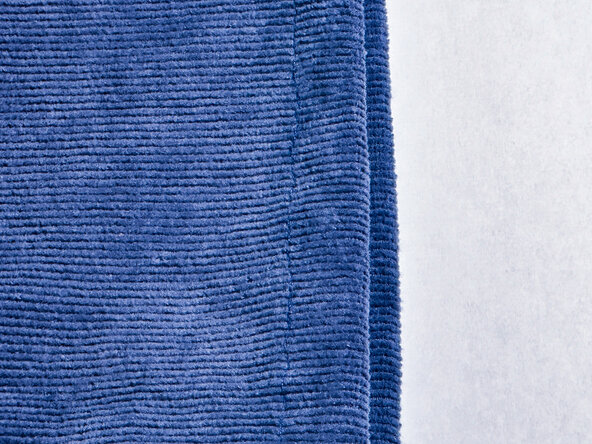

    7. Hand-Hemming Flare Corduroy Pants: étape 7, image 1 de 2 Hand-Hemming Flare Corduroy Pants: étape 7, image 2 de 2
      • Fold up the raw edge halfway to the new hemline mark.
      • Then fold it again so the raw edge is enclosed.
