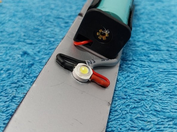

    • 3.7 V high brightness LED soldering process, heat shrink terminal protection
  7. Homemade construction tool, interior light point for toaster repair.: étape 7, image 1 de 2 Homemade construction tool, interior light point for toaster repair.: étape 7, image 2 de 2

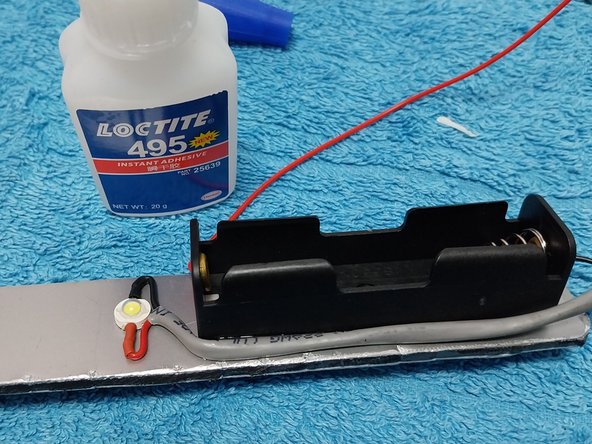

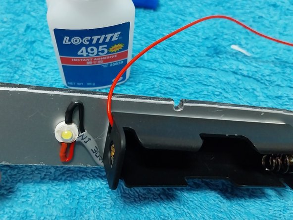

    • Double-sided adhesive tape to place the battery holder on the metal plate, previously I have placed the screw with nut, embedded that performs the interlocking of the set.
    • The LED is glued with cyanolit to the metal sheet so that it dissipates its temperature.
  10. Homemade construction tool, interior light point for toaster repair.: étape 10, image 1 de 3 Homemade construction tool, interior light point for toaster repair.: étape 10, image 2 de 3 Homemade construction tool, interior light point for toaster repair.: étape 10, image 3 de 3
    • Once the LED and battery holder are attached, the wiring is placed, fastening it with cyanolit glue on the two sides of the battery holder.
    • I proceed to solder the slide switch on the Red + wire.

    • Views of the finished set, in itself is a very simple design.
  13. Homemade construction tool, interior light point for toaster repair.: étape 13, image 1 de 3 Homemade construction tool, interior light point for toaster repair.: étape 13, image 2 de 3 Homemade construction tool, interior light point for toaster repair.: étape 13, image 3 de 3
    • 1st photo detail of the side recess used with "optional interlocking" if the rear screw does not have a suitable anchor point.
    • 2º Detail of the led.
    • 3º Detail of the switch.

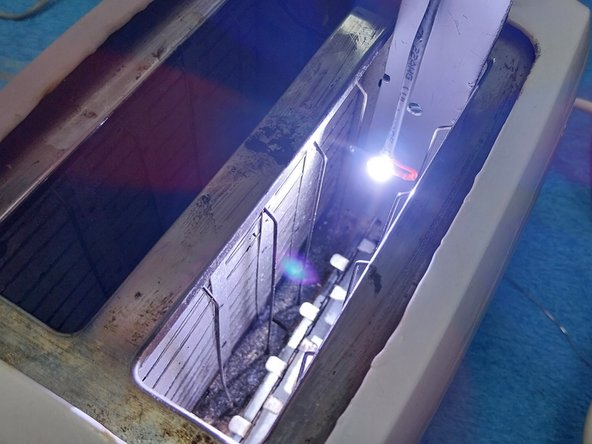

    • Inserting the tool into a DOUBLE TOASTER.
  16. Homemade construction tool, interior light point for toaster repair.: étape 16, image 1 de 3 Homemade construction tool, interior light point for toaster repair.: étape 16, image 2 de 3 Homemade construction tool, interior light point for toaster repair.: étape 16, image 3 de 3
    • The tool is locked in place and the illumination point looks like it is working, allowing us to work with 100% illumination of the interior part, compared to the other dark hole.

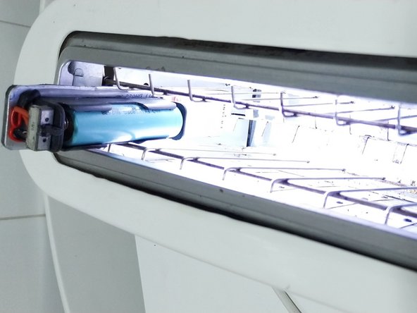

    • Comparison of the use of the light point in a single hole toaster (wider and longer than in double hole toasters).
  19. Homemade construction tool, interior light point for toaster repair.: étape 19, image 1 de 3 Homemade construction tool, interior light point for toaster repair.: étape 19, image 2 de 3 Homemade construction tool, interior light point for toaster repair.: étape 19, image 3 de 3
    • 1st photo of how the indentation is coupled to the lower part, pushing the piece where the bread rests to the bottom.''
    • 2nd photo of the lateral notch, which serves as an optional anchorage, in toasters with only one hole, holding the guide rods.
    • 3rd photo of the lateral notch without interlocking.
