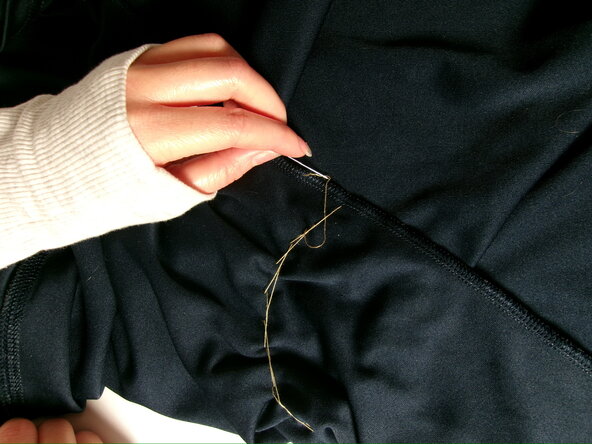

  5. How to Cinch the Waist of a Shirt: étape 5, image 1 de 1
    • Pull the thread through the eye of the needle to begin stitching.

  6. How to Cinch the Waist of a Shirt: étape 6, image 1 de 2 How to Cinch the Waist of a Shirt: étape 6, image 2 de 2
    • Tie the end of the thread into a knot by looping a hole through (as shown in the picture) and pull it tight.
    • Repeat this step 3-4 times to create a larger knot, until a visible knot forms at the end.
