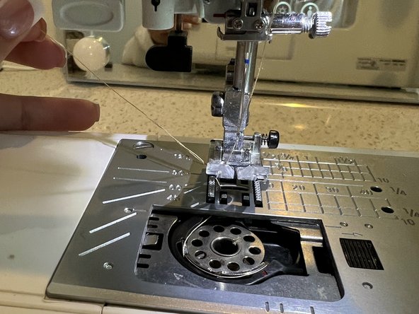

    • If the needle gets stuck while sewing a stitch, stop sewing.
    • Turn the knob on the side of your machine to manually lift the needle out of the fabric.
  2. How to Fix a Jammed Needle: étape 2, image 1 de 3 How to Fix a Jammed Needle: étape 2, image 2 de 3 How to Fix a Jammed Needle: étape 2, image 3 de 3
    • Once the needle is out of the fabric, use the block level to lift the plastic foot press from the fabric.
  3. How to Fix a Jammed Needle: étape 3, image 1 de 2 How to Fix a Jammed Needle: étape 3, image 2 de 2
    • Once the plastic foot press is lifted from the fabric, pull the fabric away from the machine and cut the thread.
  4. How to Fix a Jammed Needle: étape 4, image 1 de 3 How to Fix a Jammed Needle: étape 4, image 2 de 3 How to Fix a Jammed Needle: étape 4, image 3 de 3
    • Open the bobbin holder and remove the bobbin. Also remove the thread from the machine.
  5. How to Fix a Jammed Needle: étape 5, image 1 de 3 How to Fix a Jammed Needle: étape 5, image 2 de 3 How to Fix a Jammed Needle: étape 5, image 3 de 3

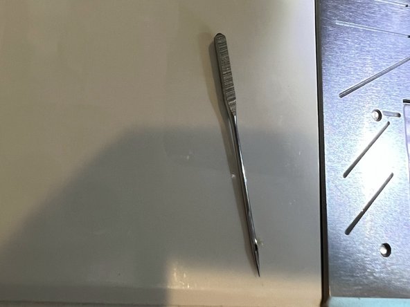

    • Using the metal knob on the right side of the needle, unscrew and remove the needle. Once the needle has been removed, inspect it for damages. If there is no damage, reinsert the same needle. If there are damages, replace the needle.
  6. How to Fix a Jammed Needle: étape 6, image 1 de 2 How to Fix a Jammed Needle: étape 6, image 2 de 2
    • Once the needle is back in the sewing machine, thread both the needle and the bobbin. From here, you are able to begin sewing again.
