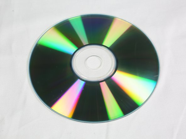

    • Rinse the disc with water and wipe clean to remove any dust or dirt.

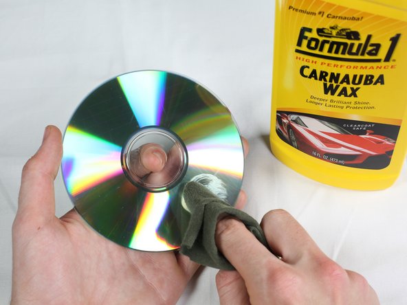

  5. How to Repair a Scratched CD: étape 5, image 1 de 3 How to Repair a Scratched CD: étape 5, image 2 de 3 How to Repair a Scratched CD: étape 5, image 3 de 3
    • Apply a thin coat of car wax directly to the CD, using a circular application method.
    • Apply in either small circular motions or large motions that follow the circumference of the disc.
  6. How to Repair a Scratched CD: étape 6, image 1 de 2 How to Repair a Scratched CD: étape 6, image 2 de 2
    • Wipe the CD clean, removing any excess wax.
