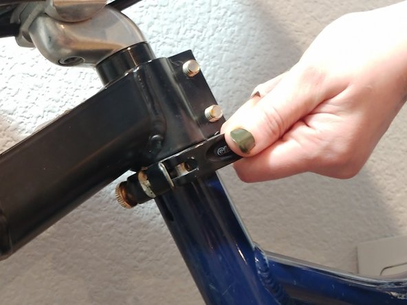

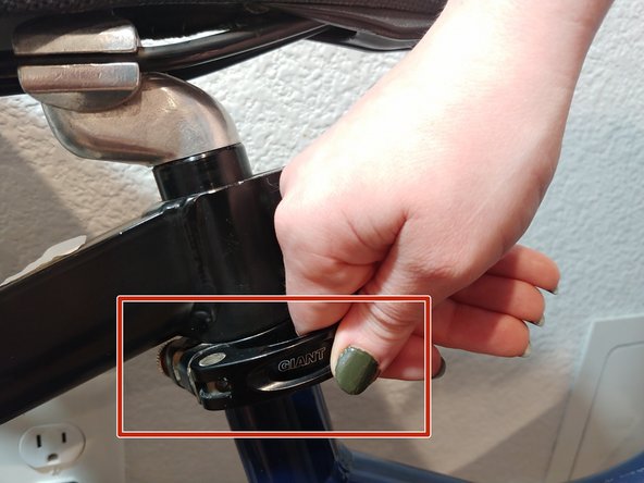

    • Lift the latch of your quick release clamp by pulling away from the bike post.

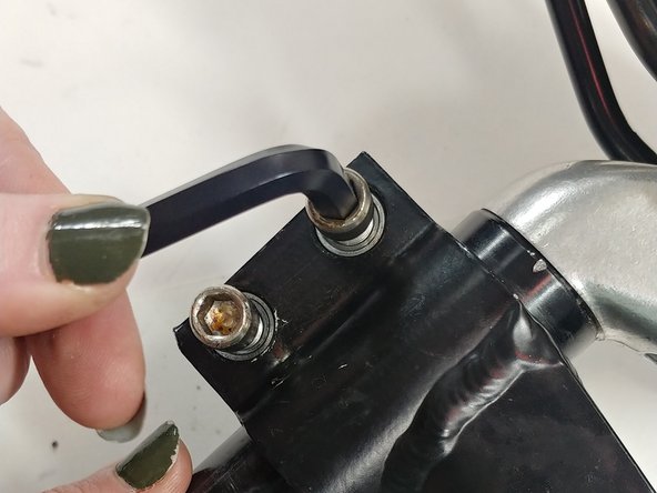

  3. How to Replace a Bike Saddle When You Have a Rear Bike Rack: étape 3, image 1 de 3 How to Replace a Bike Saddle When You Have a Rear Bike Rack: étape 3, image 2 de 3 How to Replace a Bike Saddle When You Have a Rear Bike Rack: étape 3, image 3 de 3

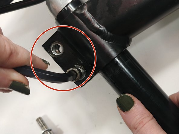

    • Grab your Hex Key (I used a 6mm Long Arm Hex Key) and secure it within one of the bolts.
    • Turn your Hex Key in a counter-clockwise direction to loosen the bolt. Repeat with second bolt if applicable.
    • Your bolt will likely have a small washer with it. Be careful not to lose this part once you pull out the bolt. Make sure you have a designated place to set any loose parts to avoid losing them.

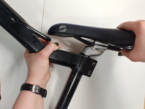

  4. How to Replace a Bike Saddle When You Have a Rear Bike Rack: étape 4, image 1 de 2 How to Replace a Bike Saddle When You Have a Rear Bike Rack: étape 4, image 2 de 2
    • Rotate the neck of the bike rack away from the base of the saddle once the bike rack's bolts are removed.
    • Make sure you have a clear view of the bolt at the base of the saddle.

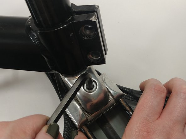

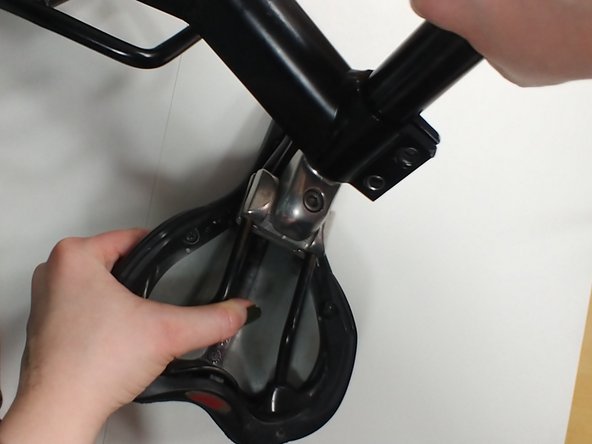

  5. How to Replace a Bike Saddle When You Have a Rear Bike Rack: étape 5, image 1 de 3 How to Replace a Bike Saddle When You Have a Rear Bike Rack: étape 5, image 2 de 3 How to Replace a Bike Saddle When You Have a Rear Bike Rack: étape 5, image 3 de 3

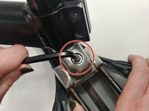

    • Place your Hex Key securely into the saddle's bolt and rotate counter-clockwise until the bolt is loose.

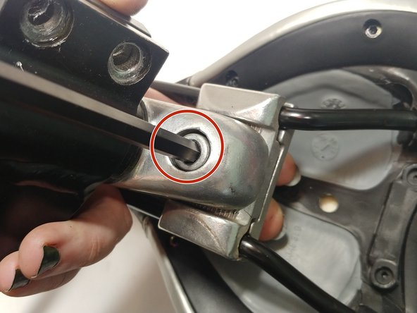

  6. How to Replace a Bike Saddle When You Have a Rear Bike Rack: étape 6, image 1 de 2 How to Replace a Bike Saddle When You Have a Rear Bike Rack: étape 6, image 2 de 2

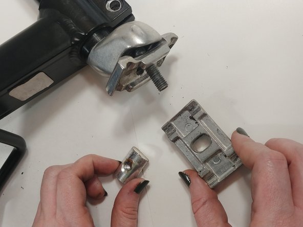

    • Remove the clamp and nut attached to the old saddle.
    • Leave the bolt and top piece of the clamp attached to the seat post.

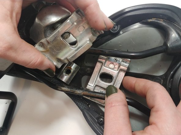

  7. How to Replace a Bike Saddle When You Have a Rear Bike Rack: étape 7, image 1 de 1

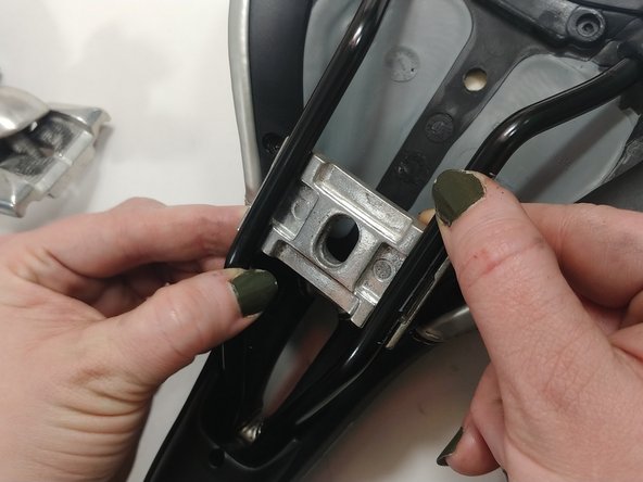

    • Place the bottom part of the clamp and nut beneath the rails of the new saddle.
    • The nut should be between the clamp and the bottom of the saddle. Make sure to line up the holes of the clamp and the nut.

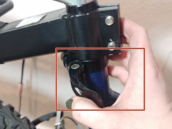

    • Push the latch of the quick release clamp towards the bike post.
    • Squeeze the quick release clamp tightly to make sure your seat post will not move.
