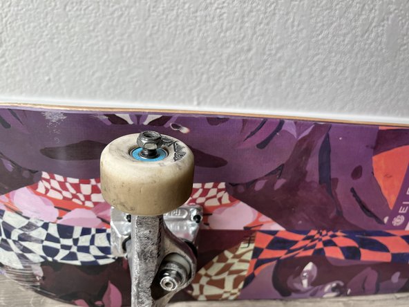

  1. How to Replace the Bearings on a Street Skateboard, Bearings: étape 1, image 1 de 1
    • Lay the skateboard on its side so that bearings and axles are facing toward you.

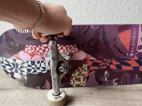

  2. How to Replace the Bearings on a Street Skateboard: étape 2, image 1 de 3 How to Replace the Bearings on a Street Skateboard: étape 2, image 2 de 3 How to Replace the Bearings on a Street Skateboard: étape 2, image 3 de 3
    • Using a skateboard tool or wrench, unscrew the axle nut above the wheel.
    • Remove the wheel from the axle.

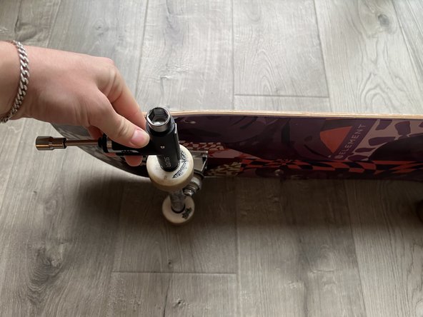

  3. How to Replace the Bearings on a Street Skateboard: étape 3, image 1 de 3 How to Replace the Bearings on a Street Skateboard: étape 3, image 2 de 3 How to Replace the Bearings on a Street Skateboard: étape 3, image 3 de 3
    • Position the wheel halfway on the end of the axle.
    • Holding the skateboard down with your other hand, use the end of the axle to pry the bearing out.

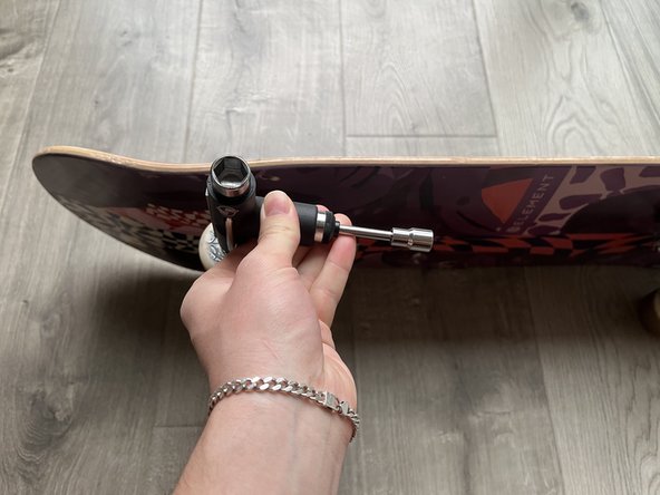

  4. How to Replace the Bearings on a Street Skateboard: étape 4, image 1 de 2 How to Replace the Bearings on a Street Skateboard: étape 4, image 2 de 2
    • Set the old bearing aside.
    • Repeat the previous step with the other side of the wheel to remove the other bearing.
