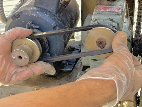

    2. How to Replace the Tension Belt On A Sliding Gate Opener: étape 2, image 1 de 2 How to Replace the Tension Belt On A Sliding Gate Opener: étape 2, image 2 de 2
      • Insert a flathead screwdriver under the old tension belt to lift it, then rotate the pulley while pulling the belt off.
      Demander à FixBot
      Ajouter un commentaire
    3. How to Replace the Tension Belt On A Sliding Gate Opener: étape 3, image 1 de 2 How to Replace the Tension Belt On A Sliding Gate Opener: étape 3, image 2 de 2
      • Put the new tension belt around the motor and over the top of the pulley.
      Demander à FixBot
    4. How to Replace the Tension Belt On A Sliding Gate Opener: étape 4, image 1 de 2 How to Replace the Tension Belt On A Sliding Gate Opener: étape 4, image 2 de 2
      • Spin the tension belt to lock it on properly to the motor and pulley.
      • Check that the tension belt moves with the motor and pulley. If it does not, manually rotate it until it seats properly and operates as intended.
