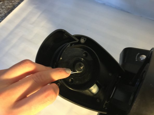

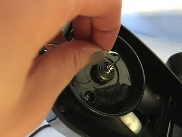

  3. How to Unclog a Keurig BVMC-KG5: étape 3, image 1 de 3 How to Unclog a Keurig BVMC-KG5: étape 3, image 2 de 3 How to Unclog a Keurig BVMC-KG5: étape 3, image 3 de 3
    • Unclog the needles using a slightly bent paperclip.
    • With the top of the Keuring open, insert the free end of the paperclip into the three small holes surrounding the needle that pierces the K-Cup.
    • Jiggle the paperclip to loosen any debris.
