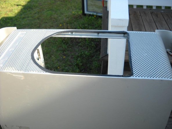

    • Mark where you are going to have to cut
  4. How to build a Mailbox out of an old Apple Power Mac G5 tower: étape 4, image 1 de 2 How to build a Mailbox out of an old Apple Power Mac G5 tower: étape 4, image 2 de 2
    • Cut a hole big enough to slide the mailbox into the case

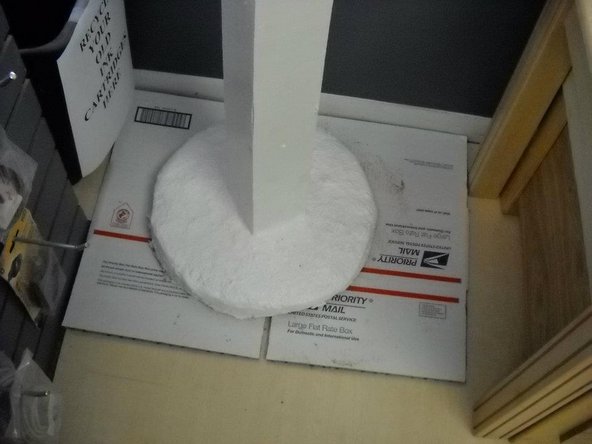

    • Take a flower pot and cut a hole in it to make a concrete base (optional) Mix the quickcrete up and fill the flower pot with it and flip it over and stick the wood pole in the concrete.
    • Use a level and something to hold the wood in a level position while it dries
  13. How to build a Mailbox out of an old Apple Power Mac G5 tower: étape 13, image 1 de 2 How to build a Mailbox out of an old Apple Power Mac G5 tower: étape 13, image 2 de 2
    • Paint the wood pole and the concrete white.
