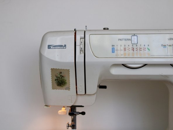

    • Turn off and unplug the sewing machine.
    • The light switch is located on the right side of the sewing machine.
  2. Kenmore 385.15516000 Lightbulb Replacement: étape 2, image 1 de 2 Kenmore 385.15516000 Lightbulb Replacement: étape 2, image 2 de 2
    • Open the light cover by pushing it towards the back of the machine.
  3. Kenmore 385.15516000 Lightbulb Replacement: étape 3, image 1 de 2 Kenmore 385.15516000 Lightbulb Replacement: étape 3, image 2 de 2
    • Push the lightbulb up and simultaneously twist the light bulb clockwise (until the button knob is to the far left as possible) and pull out the lightbulb.
  4. Kenmore 385.15516000 Lightbulb Replacement: étape 4, image 1 de 1
    • Match up the button pin of the new lighbulb to the slot.
    • Push in the new lightbulb and twist the lightbulb counter clockwise.
  5. Kenmore 385.15516000 Lightbulb Replacement: étape 5, image 1 de 1
    • The lightbulb is secure when it has been pushed in and locked in to the right.
  6. Kenmore 385.15516000 Lightbulb Replacement: étape 6, image 1 de 2 Kenmore 385.15516000 Lightbulb Replacement: étape 6, image 2 de 2
    • Close the light cover, plug in the machine, and turn it on!
