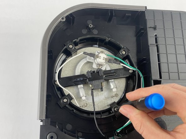

  3. Keurig K-Duo Hot Plate Replacement: étape 3, image 1 de 3 Keurig K-Duo Hot Plate Replacement: étape 3, image 2 de 3 Keurig K-Duo Hot Plate Replacement: étape 3, image 3 de 3
    • Remove the four Phillips #1 screws from each of the four tabs.
    • Pull off all four tabs which secure the hot plate in place.
