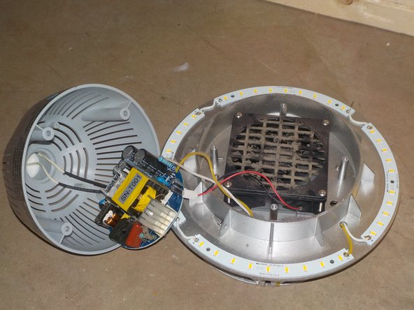

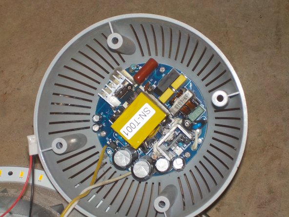

  3. Keystone Lighting HID to LED retrofit bulb Teardown, Opening the light+ driver access: étape 3, image 1 de 3 Keystone Lighting HID to LED retrofit bulb Teardown, Opening the light+ driver access: étape 3, image 2 de 3 Keystone Lighting HID to LED retrofit bulb Teardown, Opening the light+ driver access: étape 3, image 3 de 3
    • Using the same P2 screwdriver as before, you can open up the light by removing the screws recessed within the plastic. Once those are removed, you can carefully lift the top off and hang the top off the side of the light.
    • Next, you will want to unplug the fan from the driver board and remove all the screws from said driver. They are also P2.
    • Finally, you can lift the driver away from the plastic and either cut or desolder the wires going to the socket.

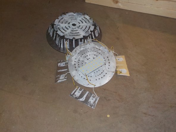

  5. Keystone Lighting HID to LED retrofit bulb Teardown, Removing the LEDs: étape 5, image 1 de 2 Keystone Lighting HID to LED retrofit bulb Teardown, Removing the LEDs: étape 5, image 2 de 2
    • All of the LED modules are held on with P2 phillips screws. You can unscrew these and lift the modules off the metal base.
    • Make sure to look out for thermal paste, because it goes everywhere.
    • To remove both the driver and these LEDs, you will want to either desolder or cut the wires.
  6. Keystone Lighting HID to LED retrofit bulb Teardown, Removing the (other) LEDs.: étape 6, image 1 de 2 Keystone Lighting HID to LED retrofit bulb Teardown, Removing the (other) LEDs.: étape 6, image 2 de 2
    • If you followed the previous step, you should have already disconnected the wires, so just go ahead and use a spudger to unstick the last few LEDs.

Thanks for the look inside one of these industrial-size high bay lights!
It would be fun to make it go again … the driver looks like a relatively simple device, and a bit of probing with an oscilloscope, and a lot of thinking and schematic sketching, might reveal which component died. :)
