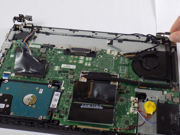

  8. Lenovo ThinkPad L460 LCD Assembly Replacement: étape 8, image 1 de 1
    • Carefully remove the cables from the cable guides.

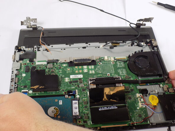

  9. Lenovo ThinkPad L460 LCD Assembly Replacement: étape 9, image 1 de 2 Lenovo ThinkPad L460 LCD Assembly Replacement: étape 9, image 2 de 2
    • Flip up the two hinged plates on the sides of the laptop.
    • Remove the LCD assembly from the laptop.
