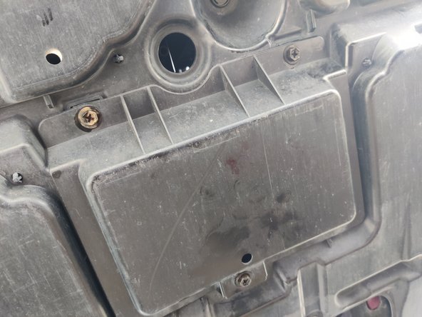

Remove the filter housing access panel with the screwdriver or 10mm socket
There are 3 screws
