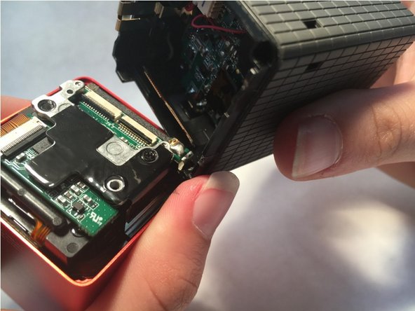

The seperation of the lens assembly and the screen assembly allows access to the motherboard
gently disconnect the two ribbon cables (indicated in red on the second image) that connect the motherboard to the lens assembly by lifting up the black pieces of the bracket and pulling gently.
There will be a slight bit of glue connecting the two potions that can be removed with a a little force.
