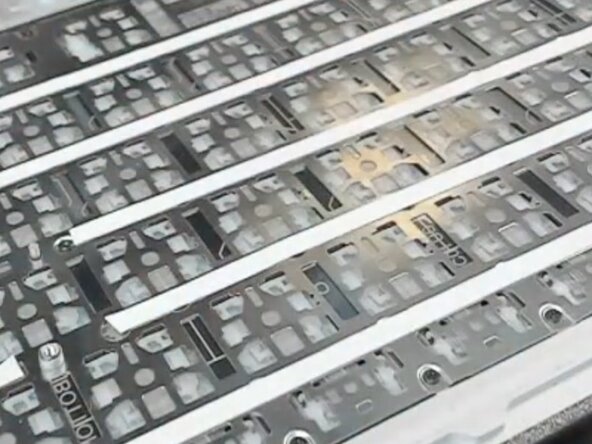

    • Before we begin it is advised to carefully read through the whole guide to get the full idea on the processes involved.
    • We begin at the stage where the top case with all its components have already been removed, except for the microphone, backlight and keyboard. We can now begin the process to remove them, install a new keyboard & if necessary a new backlight.
    • It is optional if you want to fully remove the display and the straps that connect the antenna cables to the case as they are quite tricky to get back into their locations. If kept on, then you will have to open the display and hang it off the side of the working area at all times. For this guide I have fully removed it.
    • It is optional if you want to remove the touch pad but it is not necessary to do so, I have always left it as it is without any issues.

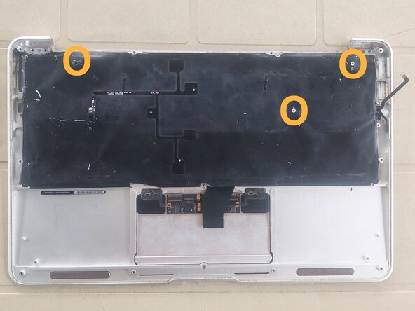

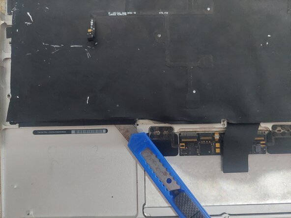

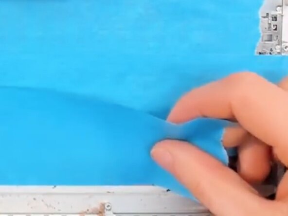

  2. MacBook Air 11" Mid 2012 keyboard Replacement, Removing the backlight: étape 2, image 1 de 3 MacBook Air 11" Mid 2012 keyboard Replacement, Removing the backlight: étape 2, image 2 de 3 MacBook Air 11" Mid 2012 keyboard Replacement, Removing the backlight: étape 2, image 3 de 3
    • We have to remove the backlight carefully as not to damage it, if you are replacing this component then you can simply pull it off.
    • The backlight consists of 3 layers, the very fragile backlight covering, a clear plastic layer and a very fragile keyboard layout template. We DO NOT want to damage these in any way if we are to use them again, so ultimate care is needed. They are stuck together but with plenty of care they can be separated.
    • Using a sharp small craft knife or similar, very carefully lift up the surrounding edge of the backlight by running the blade underneath where the adhesive is located, as we do not want to tear this extremely fragile component.
    • Some may suggest to use a heat gun but this will more than likely deform the backlight from the heat, rendering it useless.
    • Once we have a fair sized area lifted we can very gently pull away the backlight using extra care not to tear it. We can use the strength of the middle plastic sheet to assist in lifting it away. Once removed put it to the side as it will be used again in a later stage.
    • We can gently brush or wipe off any stains or debris that may have built up over time using a soft brush or cloth with some alcohol making the part nice and clean ready for re-installation.

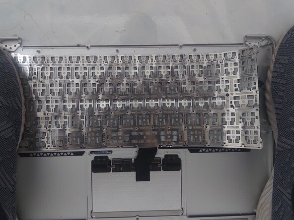

  4. MacBook Air 11" Mid 2012 keyboard Replacement, Removing the keyboard: étape 4, image 1 de 3 MacBook Air 11" Mid 2012 keyboard Replacement, Removing the keyboard: étape 4, image 2 de 3 MacBook Air 11" Mid 2012 keyboard Replacement, Removing the keyboard: étape 4, image 3 de 3
    • Once all of the screws are removed we are almost ready to remove the keyboard. We DO NOT want to bend the top case in any way shape or form, so we will FIRMLY STAND on the edges to prevent it lifting or moving as this could bend or deform the case which of course we do not want to happen.

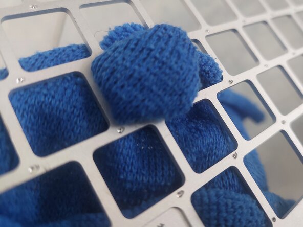

    • It is STRONGLY advised to to put on a good pair of strong thick gloves so we can first lift up the edge of the keyboard and gently bend it back enough to get a good strong grip on it. The edges of the Keyboard are VERY SHARP and will easily slice through weak materials or skin, so EXTRA CAUTION is required.
    • You can alternatively just use an old rag or a thick strong cloth to protect yourself against what can be potentially severe cuts to your fingers and knuckles when removing the keyboard.
    • * It is a good idea also to remove as many key caps as possible including their fixtures beforehand as it is always good to have some spares of these, especially if you are into repairing apple laptops or just in case your new keyboard suffers a damaged key in the future, as they will fly off everywhere when removing the keyboard.
    • * You can also put a sheet of paper or plastic under the laptop to help prevent any scratches that may occur if the case moves during the big pull, a cloth or rag will allow some flex during the violent pulling away of the keyboard which can potentially disfigure the case, something we definitely need to avoid from happening.
    • You can use some masking tape to completely cover the backside of the keyboard as this can help to catch all the rivet bits that will pop off when tearing out the keyboard.
    • Once you are set, get a TIGHT FIRM GRIP and just count to three.... 1-2-3 & RIP IT OUT in one go as fast as you can. Keys and rivets will fly everywhere so be prepared! The slower you do it the more chance there is of bending the casing or injury. Again, the edge of the keyboard is VERY SHARP and shows no mercy to hands & fingers.
    • Try not to pull upwards to much, instead pull at a level to the keyboard, as this will reduce upward stress on the case.

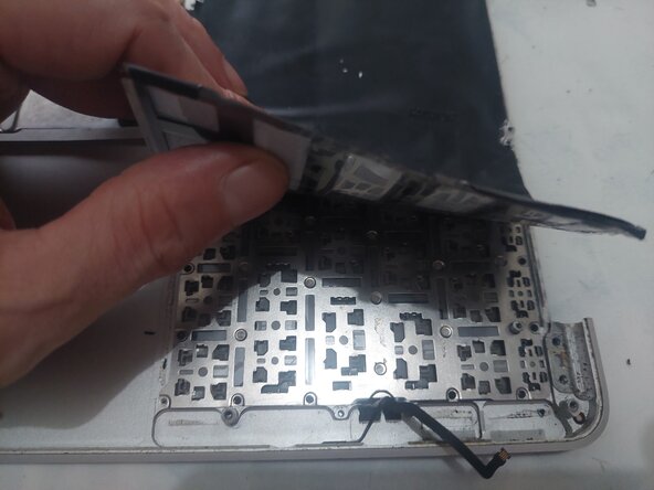

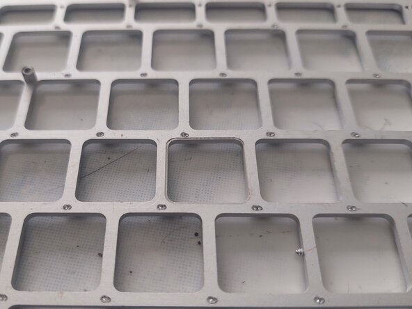

  5. MacBook Air 11" Mid 2012 keyboard Replacement, Remove any remaining rivets & dirt: étape 5, image 1 de 3 MacBook Air 11" Mid 2012 keyboard Replacement, Remove any remaining rivets & dirt: étape 5, image 2 de 3 MacBook Air 11" Mid 2012 keyboard Replacement, Remove any remaining rivets & dirt: étape 5, image 3 de 3
    • Once we have successfully ripped out the keyboard we will have to remove all the remains from the 62 or so rivets from the casing. This is not as daunting as it seems, and can take just a few minutes to complete.
    • Place the empty top case on a cloth to prevent any scratches & position it against a wall. This way the case CANNOT move while we PUNCH OUT the rivets. Avoid if possible placing it against kitchen tiles as they could easily get cracked when we are punching against them!
    • Using a flat edged tool such as a scraper, we lay the tool as flat as we can as not to cut into the casing itself and put it to the rivets and just punch them out. It is possible to get 2 or 3 out with each hit and sometimes more.
    • Some may suggest to grind of the old rivet heads with a grinder, but this takes way to long to do and may hinder removing the remaining parts of the rivets as they may become to shallow. The aim is to get the rivets to pop out leaving behind a hole in which to screw into.
    • You will notice that when the rivets fly out they will leave a perfectly sized hole for all the tiny screws that we must use to firmly secure the keyboard to the case.
    • Double check that ALL of the rivets have been successfully removed. A good idea is to run your finger where all the rivets once were to check everything is nice and smooth and that the holes are clean and ready to house a screw, otherwise the new keyboard will not sit tightly in the casing.
    • * If in the worst case scenario some of the rivets have remained and have not fully popped out of their hole or have been sheered off, we may need to use a tiny thin drill bit to drill a hole, but take care to go no deeper than 1mm, otherwise we may risk drilling right through to the other side of the case.
    • * It is also a good time to get a cloth and give a good clean out of the key holes on the casing as they are prone to collect dirt or debris from sticky fingers in the past.
