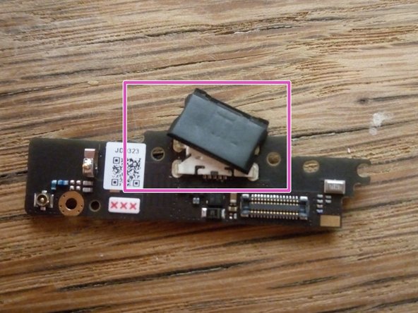

    3. Motorola Moto G4 Play USB port Replacement, remove USB board: étape 3, image 1 de 3 Motorola Moto G4 Play USB port Replacement, remove USB board: étape 3, image 2 de 3 Motorola Moto G4 Play USB port Replacement, remove USB board: étape 3, image 3 de 3
      • disconnect antenna with spudger
      • disconnect data cable with spudger
      • Remove 2 00 philips screws
      • carefully remove USB board and vibrator together
      • disconnect vibrator from board with spudger.
      • Pull the rubber support gasket off of the old usb port.
