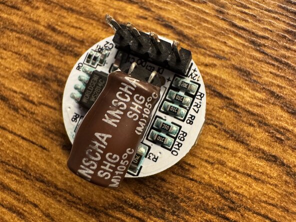

    2. Nanoleaf Outdoor String Lights - Short Circuit Repair & Waterproofing, Check PCB: étape 2, image 1 de 3 Nanoleaf Outdoor String Lights - Short Circuit Repair & Waterproofing, Check PCB: étape 2, image 2 de 3 Nanoleaf Outdoor String Lights - Short Circuit Repair & Waterproofing, Check PCB: étape 2, image 3 de 3
      • Look at the 4 pins on the back of the LED module and the slots inside the socket. Look for any green, white, or black residue (oxidation/corrosion).
      • Dip a cotton swab in Isopropyl Alcohol. Thoroughly clean the pins on the LED module.
      • Use the swab or a small brush to clean the female connectors inside the socket housing. Allow the alcohol to evaporate completely.
      • Note: The 10th LED module in every string is unique and features an electrolytic capacitor. While all other modules are interchangeable, it is recommended to position this specific module at the midpoint of the string for optimal performance.

    3. Nanoleaf Outdoor String Lights - Short Circuit Repair & Waterproofing, Reassembly and Waterproofing: étape 3, image 1 de 3 Nanoleaf Outdoor String Lights - Short Circuit Repair & Waterproofing, Reassembly and Waterproofing: étape 3, image 2 de 3 Nanoleaf Outdoor String Lights - Short Circuit Repair & Waterproofing, Reassembly and Waterproofing: étape 3, image 3 de 3
      • Apply a generous layer of silicone grease directly onto the 4 metal pins of the LED module. Reinsert the module.
      • Note regarding the "Capacitor Module": One specific module in each string (originally the 10th bulb) contains an electrolytic capacitor. While it fits anywhere, it is recommended to place this module near the middle of the string for optimal power distribution.

    4. Nanoleaf Outdoor String Lights - Short Circuit Repair & Waterproofing, Advanced Fix: étape 4, image 1 de 1
      • If not working after cleaning all PCBs.
      • With all PCBs removed. Test Continuity of the string using multimeter on one connector of the string.
      • A healthy string should show high resistance or an open circuit when not powered.
      • To find a hidden short in a long cable without visible damage, cut the remaining bad cable segment exactly in half.
      • Measure resistance on both halves. The "Good" half will show infinite resistance. The "Bad" half will show the low resistance (short).
      • Join the healthy sections back together.
      • White "+" , Black "-", Green "Data"
      • The controller dynamically counts the connected bulbs during the boot sequence. If you remove a section of the cable (e.g., due to damage), the controller will adjust automatically. The Nanoleaf App will even update the scene creator to reflect the actual number of bulbs currently connected (e.g., 55 bulbs instead of 60).
