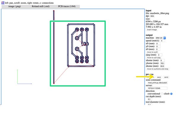

    • Upload the image to fabmodules.org.
    • Output format for "Roland mill (.rml)".
    • The process box is how thick you want the cuts. Select "PCP traces (1/64)".
  3. Prototyping a Board, Setting up the output: étape 3, image 1 de 2 Prototyping a Board, Setting up the output: étape 3, image 2 de 2
    • From the output menu, select the following: Machine: SRM-20, X0: 0, Y0: 0, X0: 0. Leave the rest as default.
    • Then select the "calculate" button.
    • Next select the "save" button.
    • The image shows the cut cut patterns. (The red lines are where the machine is picked up and moved to the next spot to cut.)
    • Repeat steps 2 and 3 but with the minor change of selecting "PCB outlines (1/32)" in the "process" option.

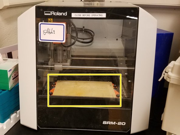

  4. Prototyping a Board, Starting the Roland SRM-20: étape 4, image 1 de 2 Prototyping a Board, Starting the Roland SRM-20: étape 4, image 2 de 2
    • Push the green button to turn on the Roland SRM-20 and plug the machine's USB into computer. Note: it must be a windows computer.
    • Open the program VPanel for SRM-20. You can download the program and manual here.
    • Hit the "on" button to run the machine for a minute to allow it to warm up.

  6. Prototyping a Board, Setting up the Roland SRM-20: étape 6, image 1 de 3 Prototyping a Board, Setting up the Roland SRM-20: étape 6, image 2 de 3 Prototyping a Board, Setting up the Roland SRM-20: étape 6, image 3 de 3
    • Set the bit and the material. And set the "home" for xy and for z. See the manual for these instructions.
    • Note: you will see this dialog box when you set the "home". Select "yes".
    • Note: there is a sacrificial board on top to protect the machine.
    • Once everything is ready, select the "output" button. This will begin cutting process.
