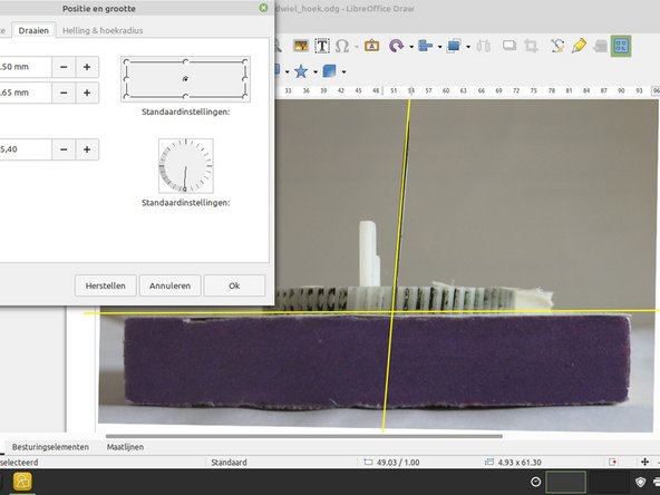

    5. Replacement of a Gearwheel in a Lightweight Carousel, or how to 3D print an existing gearwheel, wormwheel angle measurement: étape 5, image 1 de 1
      • Print the image, with a width/height ratio identical to the original image.
      • Determine pin angle by measurement Alt. import the image in LibreOffice draw or other appropriate software. In an empty draw document insert a horizontal line with minimal thickness. Import the image.
      • Align the edge of the plywood to the line, by rotation of the image (select + F4) Draw a second ‘vertical’ hairline and by rotating/moving, align it with the pin. The angle is determined as 4.6 degrees in this instance.
      • Keep the aspect ratio equal to the original image, if enlarging/reducing the image size.
