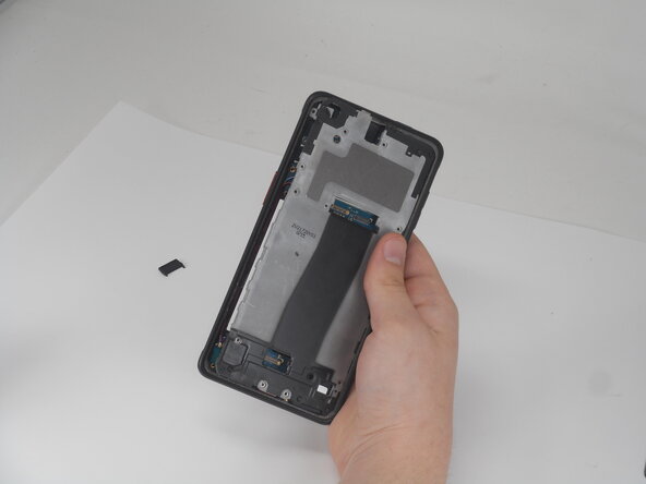

  4. Samsung Galaxy XCover Pro Charging Port Board Replacement: étape 4, image 1 de 2 Samsung Galaxy XCover Pro Charging Port Board Replacement: étape 4, image 2 de 2
    • Use a spudger or tweezers to pull the ribbon connecting the screen to the device, disconnecting it entirely.
    Demander à FixBot
    Ajouter un commentaire
  5. Samsung Galaxy XCover Pro Charging Port Board Replacement, Charging Port Board: étape 5, image 1 de 2 Samsung Galaxy XCover Pro Charging Port Board Replacement, Charging Port Board: étape 5, image 2 de 2
    • Remove the ribbon cable connecting the charging port board (bottom) and the motherboard (top).

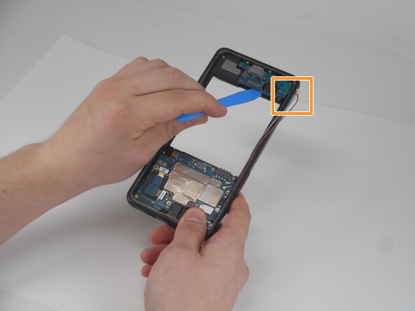

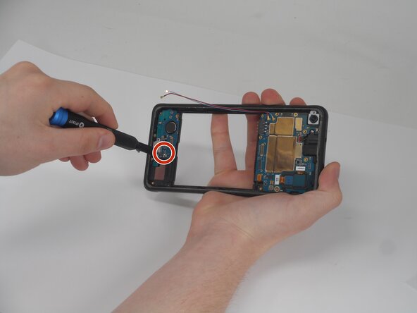

  8. Samsung Galaxy XCover Pro Charging Port Board Replacement: étape 8, image 1 de 3 Samsung Galaxy XCover Pro Charging Port Board Replacement: étape 8, image 2 de 3 Samsung Galaxy XCover Pro Charging Port Board Replacement: étape 8, image 3 de 3
    • Remove the 2.4mm screw holding the board in place with a Phillips #00 screwdriver.
    • Disconnect the two wires clipped onto the board.
    • Remove the charging port board.
