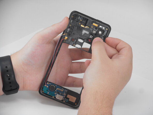

  9. Samsung Galaxy XCover Pro Headphone Jack Replacement, Headphone Jack: étape 9, image 1 de 1
    • Remove the 2.4 mm screw connecting the headphone jack to the phone with a Phillips #000 screwdriver.
    Demander à FixBot
    Ajouter un commentaire
  10. Samsung Galaxy XCover Pro Headphone Jack Replacement: étape 10, image 1 de 2 Samsung Galaxy XCover Pro Headphone Jack Replacement: étape 10, image 2 de 2
    • Using an opening tool to remove the headphone jack module from the device.
