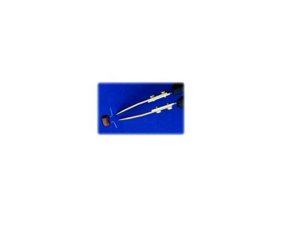

    • Small capacitance is best measured in 'Manual Mode' with 10 KHz testing frequency.
    • To Switch to 'Manual Mode', hold the navigation button down until the menu appears. Select and press MODE. Then MEASURE. Then select CAP.
    • The device is now in Capacitance Mode.
  3. Smart Tweezers LCR-meter Technique: étape 3, image 1 de 1
    • Now the Test Frequency needs to be changed to 10KHz.
    • Press the Navigation button again, and select MEASURE. Then SETTING, then T.FREQ. Select 10KHz.
    • The number on the screen that appears is the capacitance between the two tweezer tips at their default distance. This is the Capacitance Offset.
    • The offset is varied by the distance between the tips. The smaller the component, the closer the tips are together, thus a higher offset evaluation.
  4. Smart Tweezers LCR-meter Technique: étape 4, image 1 de 3 Smart Tweezers LCR-meter Technique: étape 4, image 2 de 3 Smart Tweezers LCR-meter Technique: étape 4, image 3 de 3
    • To store the offset so Smart Tweezers can automatically deduce it from measurements, first, enter the menu, select MODE, and set the device to manual CAP measurement.
    • Then select HOLD
    • Set the tweezer tips apart to a distance equal to the component to be measured. This is the offset.
    • Enter the NULL menu, and select SET.
    • An asterisk will appear beside the test mode indicator while measuring to indicate an offset has been stored.
