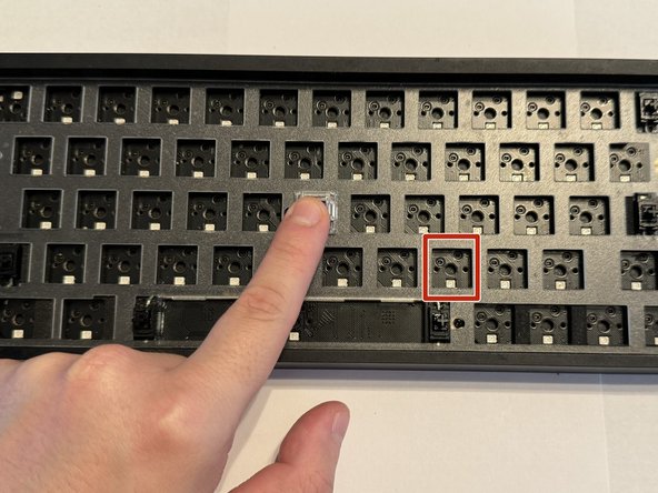

  3. Tofu65 Keyboard PCB Replacement: étape 3, image 1 de 1
    • Use the switch puller to pinch the switch on the two pins to release the switch from the PCB.
    • Pull straight up when removing the switch. It should not take much force to pull them out.

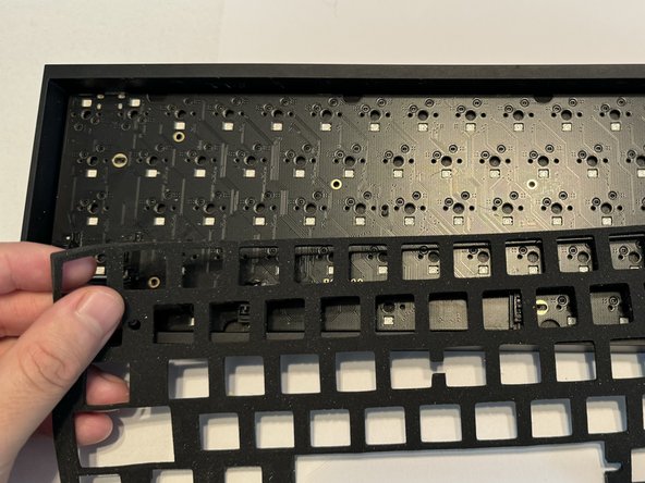

  5. Tofu65 Keyboard PCB Replacement: étape 5, image 1 de 2 Tofu65 Keyboard PCB Replacement: étape 5, image 2 de 2
    • Gently remove the foam layer protecting the PCB.

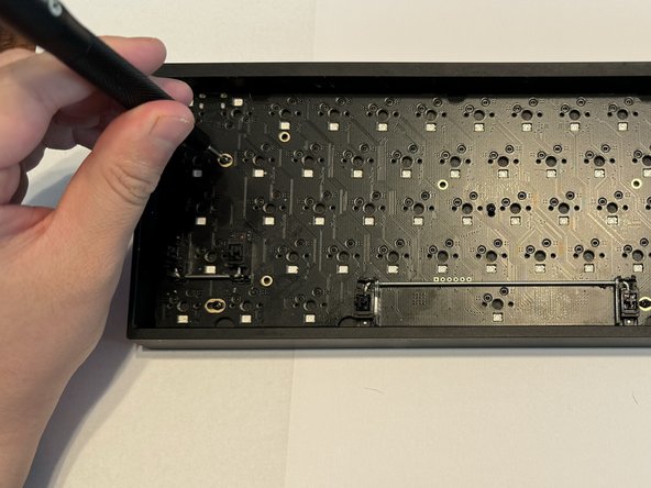

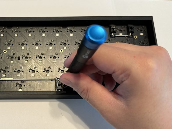

  6. Tofu65 Keyboard PCB Replacement: étape 6, image 1 de 3 Tofu65 Keyboard PCB Replacement: étape 6, image 2 de 3 Tofu65 Keyboard PCB Replacement: étape 6, image 3 de 3
    • Use a Phillips #000 screwdriver to remove the six 5 mm screws keeping the PCB in place.

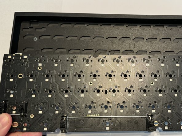

  7. Tofu65 Keyboard PCB Replacement: étape 7, image 1 de 2 Tofu65 Keyboard PCB Replacement: étape 7, image 2 de 2
    • Remove the old PCB from the bottom case.

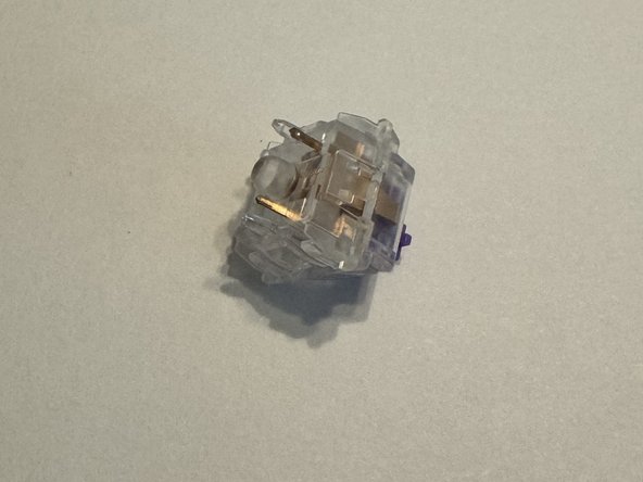

  8. Tofu65 Keyboard PCB Replacement: étape 8, image 1 de 2 Tofu65 Keyboard PCB Replacement: étape 8, image 2 de 2
    • Ensure your keyboard switches are in good condition and the golden pins are not bent.
    • If the pins are bent, carefully bend them so they are straight or replace them with new switches.

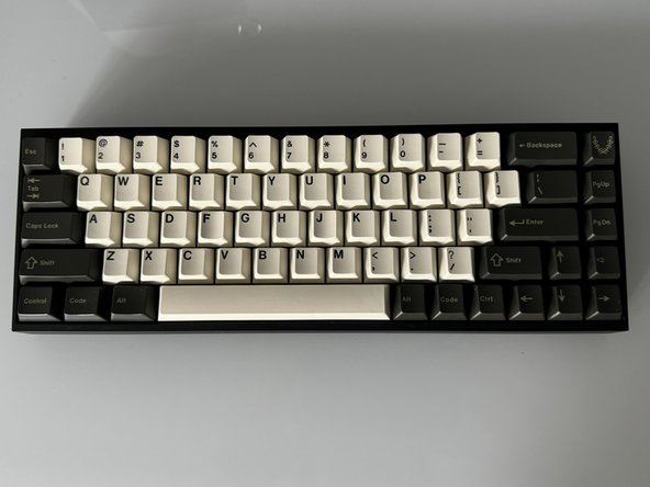

  10. Tofu65 Keyboard PCB Replacement: étape 10, image 1 de 2 Tofu65 Keyboard PCB Replacement: étape 10, image 2 de 2
    • Replace each keycaps onto the appropriate switch.
    • Press down firmly on each to ensure they are making contact.
