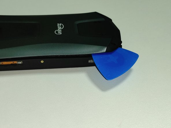

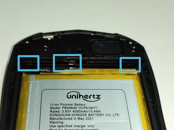

  3. Unihut Titan Pocket Keyboard Disassembly Guide, Back plate disassembly: étape 3, image 1 de 3 Unihut Titan Pocket Keyboard Disassembly Guide, Back plate disassembly: étape 3, image 2 de 3 Unihut Titan Pocket Keyboard Disassembly Guide, Back plate disassembly: étape 3, image 3 de 3
    • Insert the opening pick into the gap between the body and the back plate. Then open the gap so that the latch comes out.
    • There are three latches on the left and right, one on the top and two on the bottom.

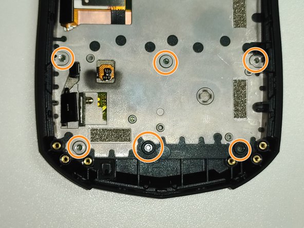

  4. Unihut Titan Pocket Keyboard Disassembly Guide, Bottom part disassembly: étape 4, image 1 de 3 Unihut Titan Pocket Keyboard Disassembly Guide, Bottom part disassembly: étape 4, image 2 de 3 Unihut Titan Pocket Keyboard Disassembly Guide, Bottom part disassembly: étape 4, image 3 de 3
    • Remove the 3 screws using a Phillips #000 screwdriver.
    • Use the opening tool to open the gap.

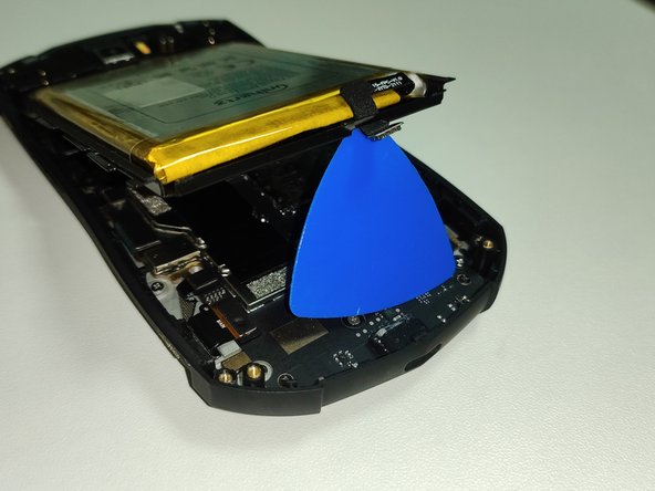

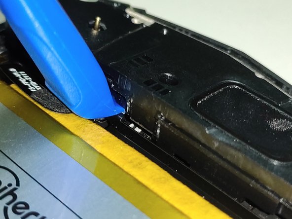

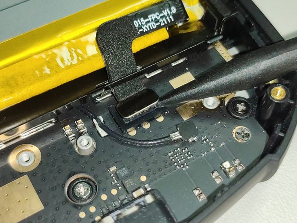

  5. Unihut Titan Pocket Keyboard Disassembly Guide, Battery disassembly: étape 5, image 1 de 3 Unihut Titan Pocket Keyboard Disassembly Guide, Battery disassembly: étape 5, image 2 de 3 Unihut Titan Pocket Keyboard Disassembly Guide, Battery disassembly: étape 5, image 3 de 3
    • Remove the battery connector.
    • Do not remove including a black sponge. Only disconnect the silver connector.
    • Then, lift the battery.

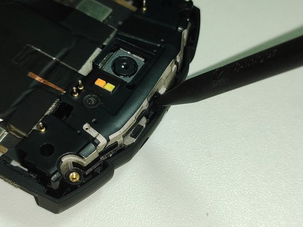

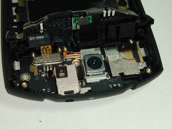

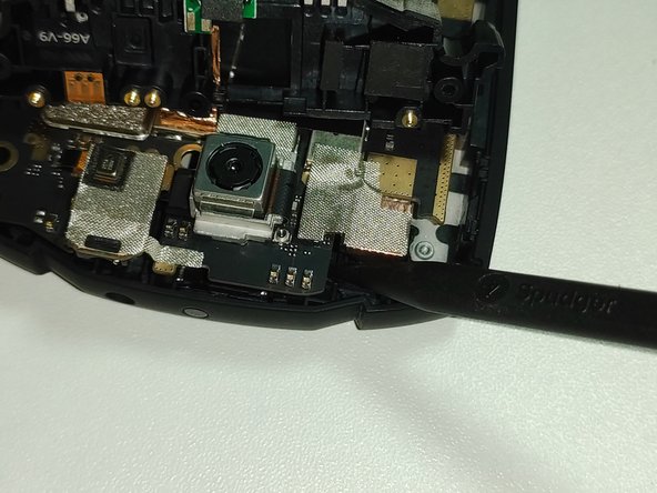

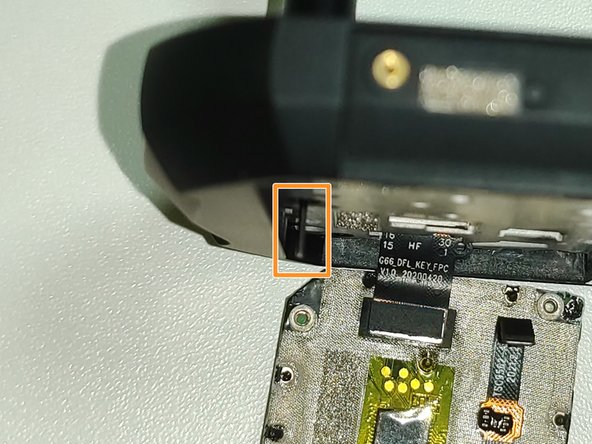

  6. Unihut Titan Pocket Keyboard Disassembly Guide, Upper part disassembly: étape 6, image 1 de 3 Unihut Titan Pocket Keyboard Disassembly Guide, Upper part disassembly: étape 6, image 2 de 3 Unihut Titan Pocket Keyboard Disassembly Guide, Upper part disassembly: étape 6, image 3 de 3
    • Remove the 2 screws using a Phillips #000 screwdriver.
    • Lift the top part with the pointed part of the Spudger.
    • You don't have to remove the metal sticker by just lifting the top part.
    • If the camera or earphone jack connector is disconnected during the lifting process, reconnect it.

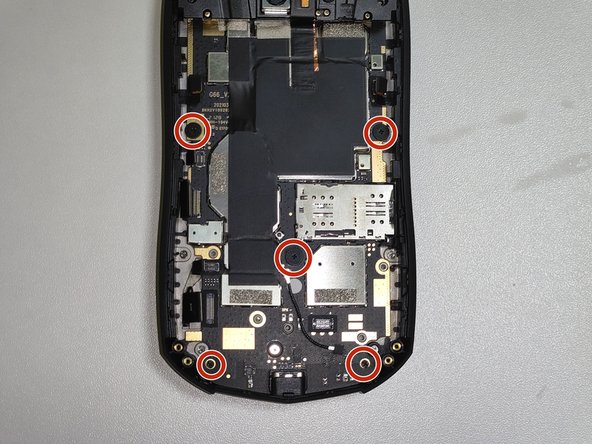

  7. Unihut Titan Pocket Keyboard Disassembly Guide, Motherboard disassembly: étape 7, image 1 de 3 Unihut Titan Pocket Keyboard Disassembly Guide, Motherboard disassembly: étape 7, image 2 de 3 Unihut Titan Pocket Keyboard Disassembly Guide, Motherboard disassembly: étape 7, image 3 de 3
    • Disconnect the 6 connectors.
    • Remove the 5 screws using a Phillips #000 screwdriver.
    • Use the Spudger to lift the top of the motherboard.
