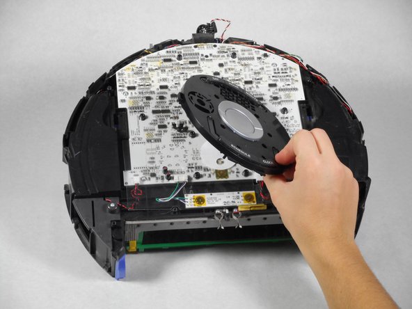

  • Using the Phillips #1 driver, unscrew the four 10 mm screws that surround the clean button.
  • Remove the top of the control board.
En utilisant un tournevis cruciforme JIS n° 1, dévissez les quatre vis 10 mm qui entourent le bouton « clean ».
Retirez les boutons au-dessus de la carte de contrôle.
-[* red] Using the Phillips JIS #1 driver, unscrew the four 10 mm screws that surround the clean button.
+[* red] Using the Phillips #1 driver, unscrew the four 10 mm screws that surround the clean button.
[* black] Remove the top of the control board.
