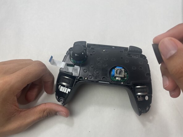

  5. 8BitDo Ultimate Wireless Joystick Cover Replacement, Joystick Covers: étape 5, image 1 de 1
    • Grip each joystick cap firmly and pull straight up to remove them.
