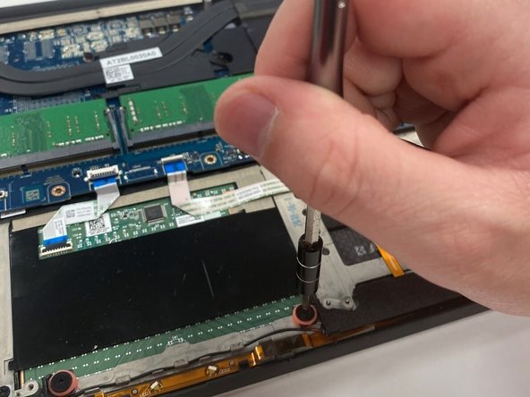

    1. Changement haut-parleurs Dell XPS 15 9570, Haut-parleurs: étape 8, image 1 de 2 Changement haut-parleurs Dell XPS 15 9570, Haut-parleurs: étape 8, image 2 de 2
      • Retirez les haut-parleurs de l'arrière de l'ordinateur.
      • Remplacez les haut-parleurs par la batterie Dell 6GTPY 91 Wh.

Thank you for the tutorial!
Just did the swap with speakers form a DELL XPS 15 from an unknown model (most likely wasn't a 9570). Note that these speakers are common inbetween different XPS 15 models (at least XPS 9550 9560 M5510 9350 5520 5510 and Precision 5510 5520 5530 5540 PK23000RP00 TX47W 0TX47W) ******and can be interchanged.
The ones I just used were salvaged from an out-of-service XPS 15 but the parts can be sourced online easily (ex: https://www.amazon.com/Deal4GO-Speaker-R... )
Cheers
