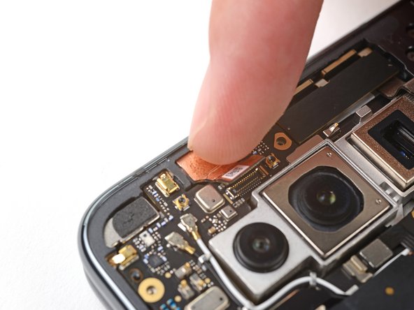

    1. How to Apply New Base Front Camera Adhesive in Your Google Pixel Fold, Remove the old adhesive: étape 1, image 1 de 2 How to Apply New Base Front Camera Adhesive in Your Google Pixel Fold, Remove the old adhesive: étape 1, image 2 de 2
      Outil utilisé dans cette étape :
      • Use tweezers, or your fingers, to remove any chunks of adhesive from the frame.
      Demander à FixBot
      Ajouter un commentaire

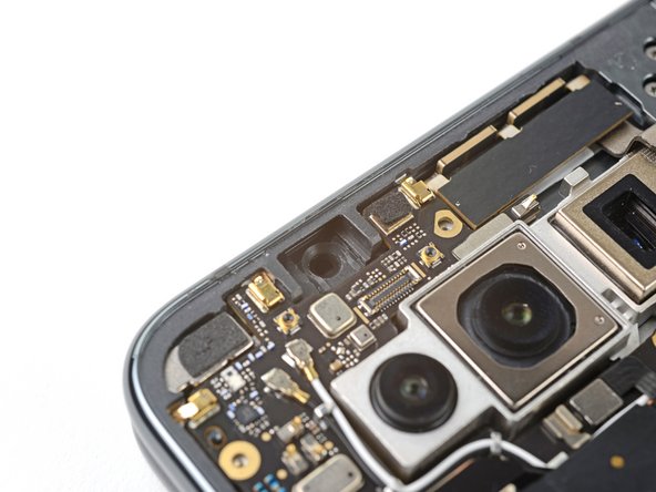

    2. How to Apply New Base Front Camera Adhesive in Your Google Pixel Fold, Apply the adhesive: étape 2, image 1 de 3 How to Apply New Base Front Camera Adhesive in Your Google Pixel Fold, Apply the adhesive: étape 2, image 2 de 3 How to Apply New Base Front Camera Adhesive in Your Google Pixel Fold, Apply the adhesive: étape 2, image 3 de 3
      • Peel off the new adhesive strip from its clear liner.
      • Apply the sticky side in the front camera recess.
      • Use a spudger, or your fingers, to press down the adhesive and ensure a good seal.
      Demander à FixBot

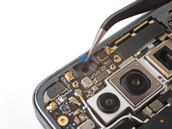

    3. How to Apply New Base Front Camera Adhesive in Your Google Pixel Fold, Secure the camera: étape 3, image 1 de 3 How to Apply New Base Front Camera Adhesive in Your Google Pixel Fold, Secure the camera: étape 3, image 2 de 3 How to Apply New Base Front Camera Adhesive in Your Google Pixel Fold, Secure the camera: étape 3, image 3 de 3
      • Use tweezers, or your fingers, to peel off the blue liner and expose the two halves of adhesive.
      • Insert the front camera and apply pressure to adhere it to the frame.
      Demander à FixBot
