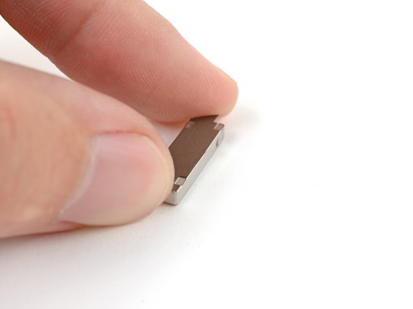

    • Use tweezers, or your fingers, to peel off the adhesive strip from the bottom of the base vibrator.

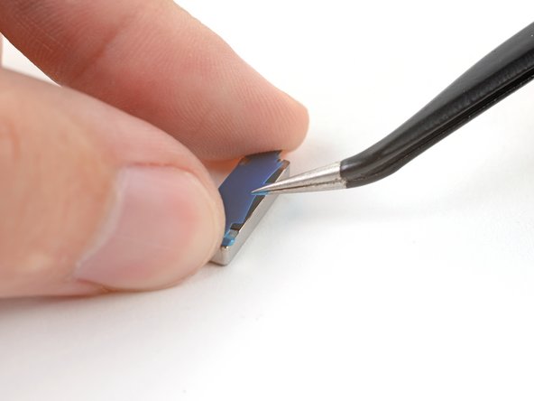

    • Peel off the new adhesive strip from its liner and apply the sticky side to the vibrator.
    • Use a spudger, or your fingers, to press down the adhesive and adhere it.
