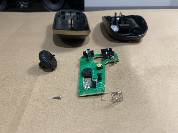

    • Use a Phillips screwdriver to remove the 5x10mm screw that secures the upper and lower case.
    • Remove the top cover.
  2. JUKSTG Computer Mouse LED Replacement LED Light Replacement: étape 2, image 1 de 3 JUKSTG Computer Mouse LED Replacement LED Light Replacement: étape 2, image 2 de 3 JUKSTG Computer Mouse LED Replacement LED Light Replacement: étape 2, image 3 de 3

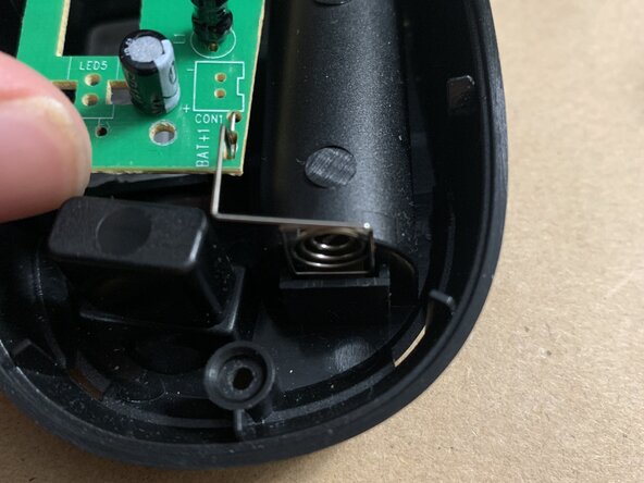

    • Remove the scroll wheel and gently remove the mainboard.
    • Flip over the mainboard to expose the soldered LED connections.

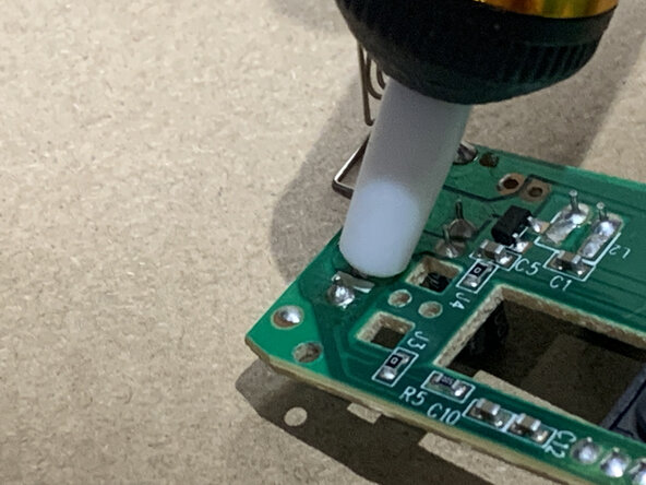

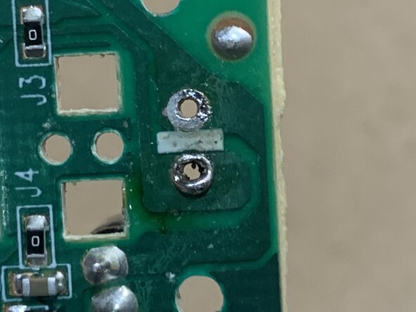

    • Pre-heat a soldering iron and leave it on standby until it reaches at least 350 C (662 F). Prepare a desoldering pump by pushing down on the plunger.
    • Once the soldering iron reaches 350 C, press the tip gently on each side of the old solder and wait for it to melt, one connection at a time.
    • The melting process may either be instantaneous or take a few seconds.
    • Once the solder is melted, quickly cover the melted solder with the tip of the desoldering vacuum and press the button to suck up the molten solder.

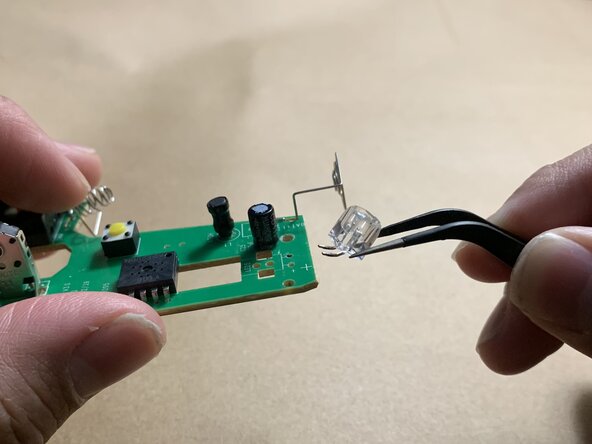

    • The removal process should end when there are visible holes where the solder used to be. The old LED light should fall off during this process.
    • CAUTION: Soldering iron is extremely HOT. Always solder in a well-ventilated area or with a running fume extractor.

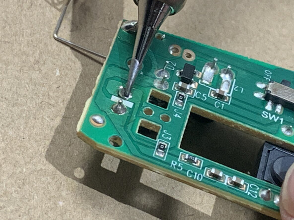

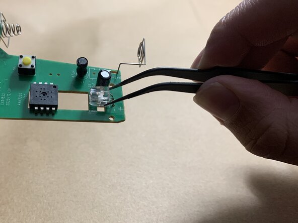

    • Flip the mainboard upside down and insert the new LED in the same orientation and polarity as the old LED.
    • Flip over the control panel again and ensure the new LED is supported in the holes.
    • A piece of masking tape can be used to hold the LED in place.
    • To ensure the new LED is placed in the correct orientation, determine the polarity. Polarity refers to the electrical current flow between the anode (positive +) and cathode (negative -) terminals. The long leg will most likely be the anode and must be connected as such.

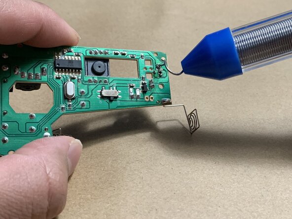

    • Press the iron tip against the right pad and LED lead for 2-3 seconds, then feed enough solder into the joint to encapsulate the lead.
    • The ideal joint will look smooth and concave, like a cartoon volcano.
    • Remove the solder, then remove the iron.
    • Repeat the previous bullets in this step for the other joint.
    • CAUTION: Do not tamper with the solder as it melts, for it will harden almost immediately.
    • Tin the tip of your iron, then power it down and wait for it to fully cool prior storage.

    • When putting everything together, ensure that the battery cables are inserted in the slot specifically for them, or the top cover will not fit properly.
