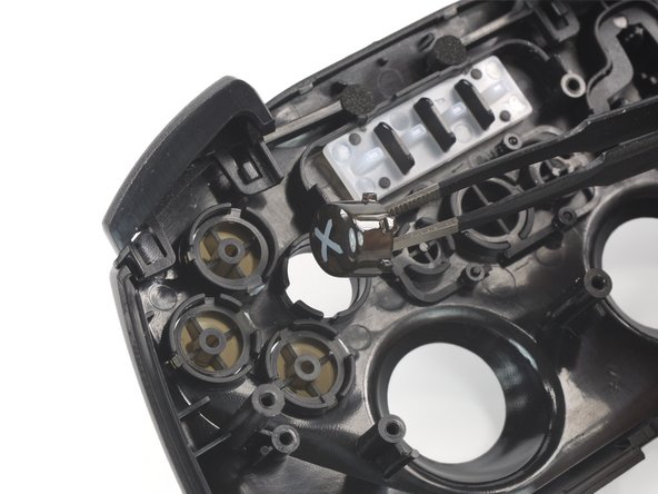

  16. SteelSeries Nimbus+ Controller Face Buttons Replacement, Remove the face buttons: étape 16, image 1 de 3 SteelSeries Nimbus+ Controller Face Buttons Replacement, Remove the face buttons: étape 16, image 2 de 3 SteelSeries Nimbus+ Controller Face Buttons Replacement, Remove the face buttons: étape 16, image 3 de 3
    Outil utilisé dans cette étape :
    • Use a pair of tweezers to remove the face buttons from the housing.
    • The alignment pegs on each button are designed to prevent incorrect installation. Make sure your new buttons fit properly in the controller case.
