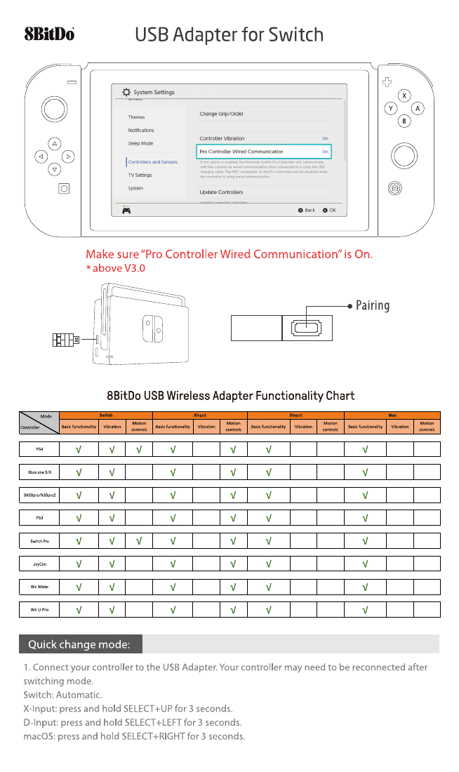

Make sure "Pro Controller Wired Communication" is On.
  • above V3.0

8BitDo USB Wireless Adapter Functionality Chart
Controller\ModeSwitchXinputDinputMac
Basic functionalityVibrationMotion controlsBasic functionalityVibrationMotion controlsBasic functionalityVibrationMotion controlsBasic functionalityVibrationMotion controls
PS4✓✓✓✓✓✓✓
Xbox one S/X✓✓✓✓✓✓
SN30pro/N30pro2✓✓✓✓✓✓
PS3✓✓✓✓✓✓
Switch Pro✓✓✓✓✓✓✓
JoyCon✓✓✓✓✓✓
Wii Mote✓✓✓✓✓✓
Wii U Pro✓✓✓✓✓✓
Quick change mode:
  1. Connect your controller to the USB Adapter. Your controller may need to be reconnected after switching mode.
Switch: Automatic.
X-Input: press and hold SELECT+UP for 3 seconds.
D-Input: press and hold SELECT+LEFT for 3 seconds.
macOS: press and hold SELECT+RIGHT for 3 seconds.
