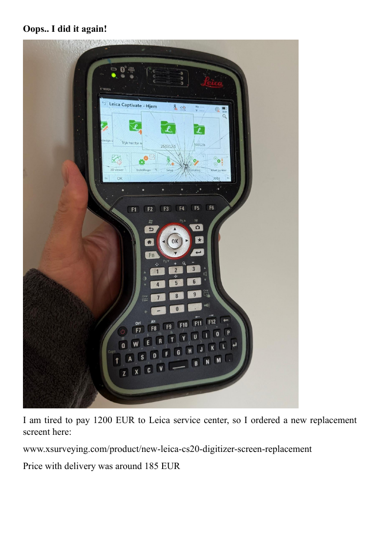

I am tired to pay 1200 EUR to Leica service center, so I ordered a new replacement screent here:
www.xsurveying.com/product/new-leica-cs20-digitizer-screen-replacement Price with delivery was around 185 EUR
