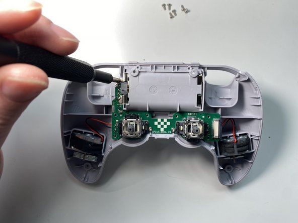

    3. 8BitDo SN30 Pro+ Controller Analog Sticks Replacement, Remove Screws: étape 8, image 1 de 3 8BitDo SN30 Pro+ Controller Analog Sticks Replacement, Remove Screws: étape 8, image 2 de 3 8BitDo SN30 Pro+ Controller Analog Sticks Replacement, Remove Screws: étape 8, image 3 de 3
      • Use a Phillips screwdriver to remove the nine 5.2 mm screws securing the rear circuit board.
      • Four around the Right stick
      • Four around the Left stick
      • One next to the Battery connector

    4. 8BitDo SN30 Pro+ Controller Analog Sticks Replacement, Separate Rear Board: étape 9, image 1 de 3 8BitDo SN30 Pro+ Controller Analog Sticks Replacement, Separate Rear Board: étape 9, image 2 de 3 8BitDo SN30 Pro+ Controller Analog Sticks Replacement, Separate Rear Board: étape 9, image 3 de 3
      • Pull the two rumble motors out of their housings.
      • Grab the analog sticks to pull out the circuit board
      Demander à FixBot
      Ajouter un commentaire

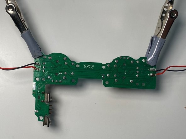

    1. 8BitDo SN30 Pro+ Controller Analog Sticks Replacement, Desolder Analog Sticks: étape 10, image 1 de 3 8BitDo SN30 Pro+ Controller Analog Sticks Replacement, Desolder Analog Sticks: étape 10, image 2 de 3 8BitDo SN30 Pro+ Controller Analog Sticks Replacement, Desolder Analog Sticks: étape 10, image 3 de 3
      • Flip over the rear board.
      • Using a soldering iron to desolder all the joints of the analog sticks.
      • Make sure all the solder holes are open on the circuit board.
      • Refer to the following solder guide if necessary: How To Solder and Desolder Connections
